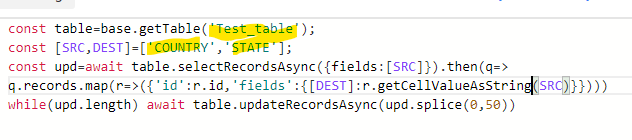

Sorry for my cognitive bias, I expect it to be obvious and told it, as if I explain to another coder. Also, my English is far from perfect.
You should set 3 values: your table name and field names here, like this:
Also, use getCellValueasString(SRC) to read Lookup field as string
destination field should be writable (not Lookup), and preferably SingleText or LongText.
