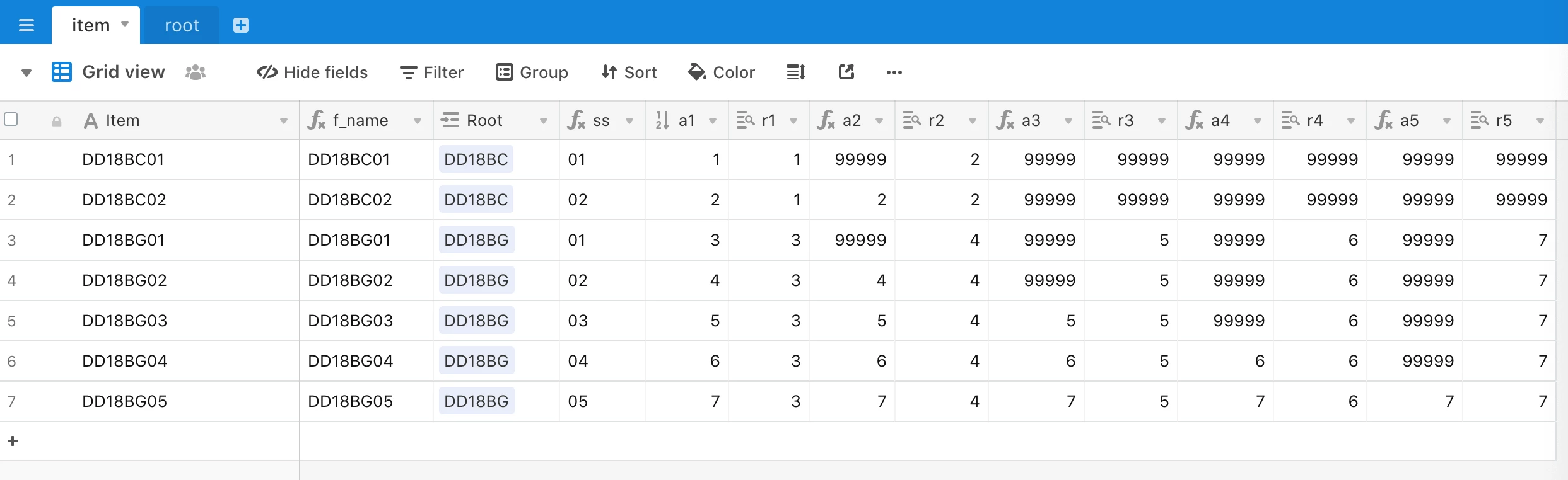

I use to manage inventory, so I definitely understand the need for sequential SKUs. I did manage to create a Frankenstein version of what you are asking for:

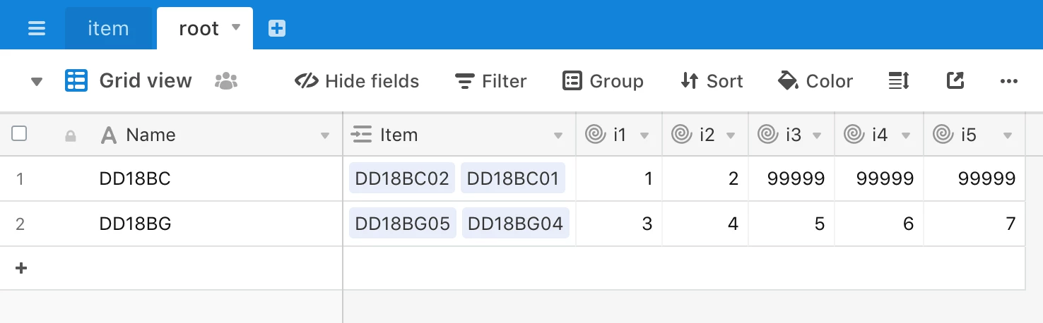

It uses a table where the primary field is the first four digits of the SKU:
What it’s essentially doing is finding the lowest auto number to find the first record. And then essentially removing that number. And then repeating. After all that the formula ‘ss’ creates a two-digit string. That is then joined with the first four digits in the ‘f_name’ formula.
I couldn’t make Item be a formula because it causes a circular error. Here is a link to the base:
Sequential SKUs

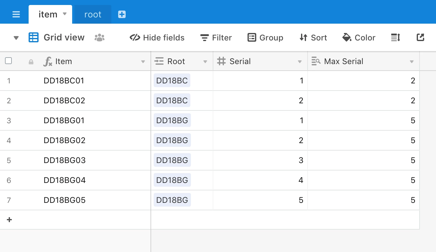

If your SKUs normally don’t go to a high number this might be the way to go. Otherwise, I’d consider doing something like this:

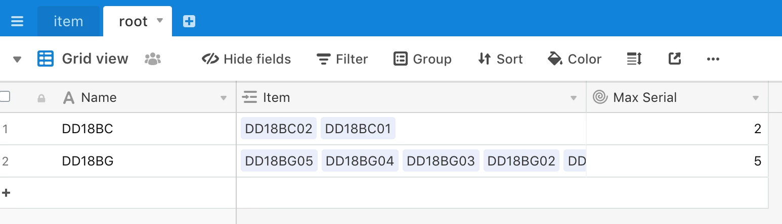

With a similar root table:
This would help a lot with manual entry and doesn’t require such a complicated structure.
