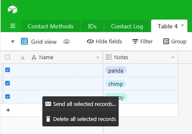

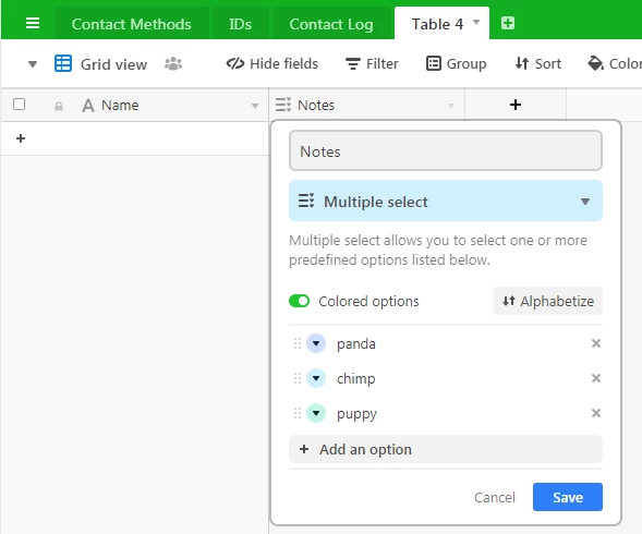

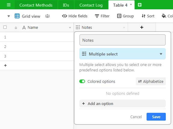

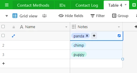

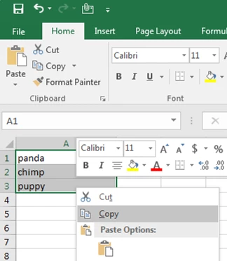

I think there is a quick and dirty way to do this(how I usually modify my multi/single select lists).
  • Create X number of new blank records(or let it auto expand and fill)
  • paste a list of values into the multiple select field and they will be added to the list
  • delete extraneous records
CTRL-V
delete records
Voila

If you just want to add a bunch of new possible selections to a Multi/Single-Select field, what’s wrong with @Mike_McLaughlin’s solution above? It seems like it does what you want, you just have to delete the extra records afterward which can be done in two clicks
