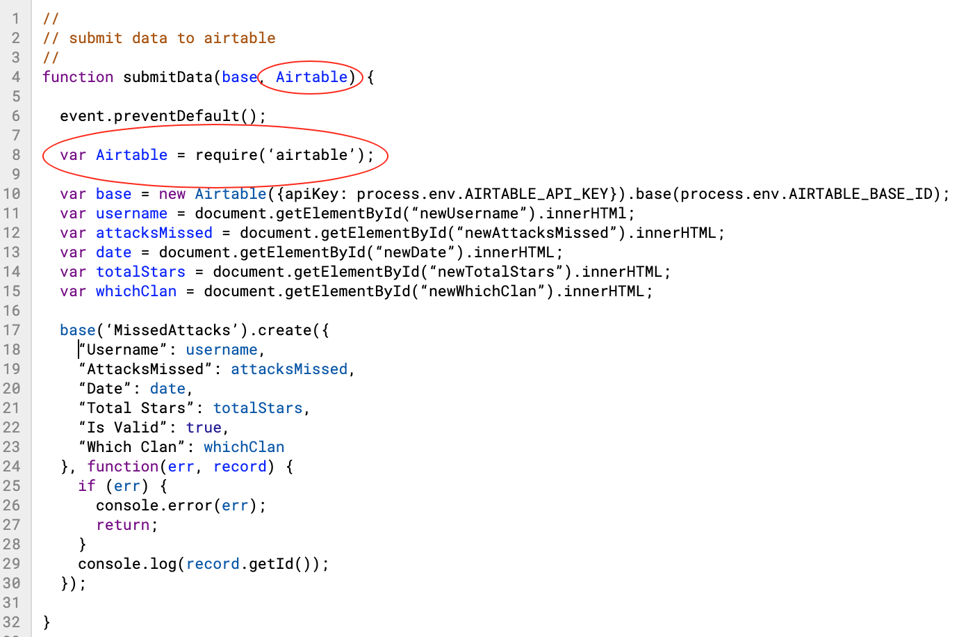

The code above is just the code i need to run. How i actually try is like this:
function submitData(base, Airtable) {
event.preventDefault()
var Airtable = require(‘airtable’);
var base = new Airtable({apiKey: process.env.AIRTABLE_API_KEY}).base(process.env.AIRTABLE_BASE_ID);
var username = document.getElementById(“newUsername”).innerHTMl;
var attacksMissed = document.getElementById(“newAttacksMissed”).innerHTML;
var date = document.getElementById(“newDate”).innerHTML;
var totalStars = document.getElementById(“newTotalStars”).innerHTML;
var whichClan = document.getElementById(“newWhichClan”).innerHTML;
base(‘MissedAttacks’).create({
“Username”: username,
“AttacksMissed”: attacksMissed,
“Date”: date,
“Total Stars”: totalStars,
“Is Valid”: true,
“Which Clan”: whichClan
}, function(err, record) {
if (err) {
console.error(err);
return;
console.log(record.getId());
These are input boxes on my page.

Okay, I believe this is a problem…
Loading the SDK (line 8) creates an object (i.e., Airtable) that should be statically declared (Const?) outside any functions that use it. I am assuming that you are sharing the server-side (NodeJS) code here.
As you have it, the Airtable parameter passed into your submitData() function is attempting to make is a dynamic variable, and the var (re-declaration) is likely throwing an error.
I’m not an expert in all the nuances of NodeJS or even the Airtable SDK as I tend to build custom equivalents of the SDK into my existing integration frameworks. But, I think if you move line 8 outside the function and drop the Airtable argument (from that function), it might work.
  • August 24, 2019
