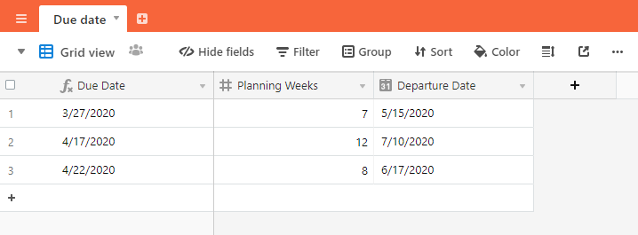

Hi everyone.
I have 3 Columns. DUE DATE, PLANNING WEEKS & DEPARTURE DATE
I want to use a formula that sets the DUE DATE by looking at the DEPARTURE DATE and subtracts the number of PLANNING WEEKS.
In other words, I want to automatically set my DUE DATE of each task by the PLANNING WEEKS before we depart(DEPARTURE DATE).

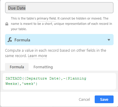

Hello Brian,
If I understand you correctly, I think we can use the DATEADD formula to set this up.
Based on your specifications I set up a test base:
I then created a formula in the first column that looks like this:
Your first field here will then be the number of planning weeks before the departure date. Hopefully I was helpful and able to answer your question sufficiently.

Hello Brian,

I am so impressed with this community! You solved it and so fast. Thank you so much.
