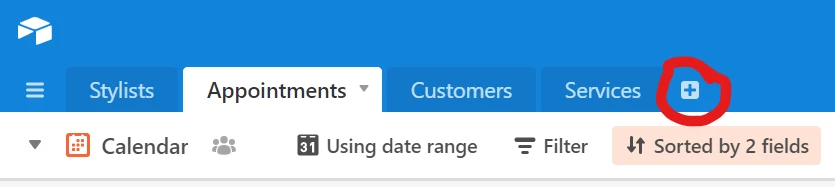

I believe Jonathan is refering to the “Create New Table” button at the top of Airtable’s user interface:
You’d have to create a table by clicking that button and setting up your fields in the grid view. Then you should be able to write to that table using your custom block. You’ll have to switch your definition of your variable tab to something like this: const tab = base.getTableByNameIfExists('My First Table') , assuming the “My First Table” is indeed the name of your table.

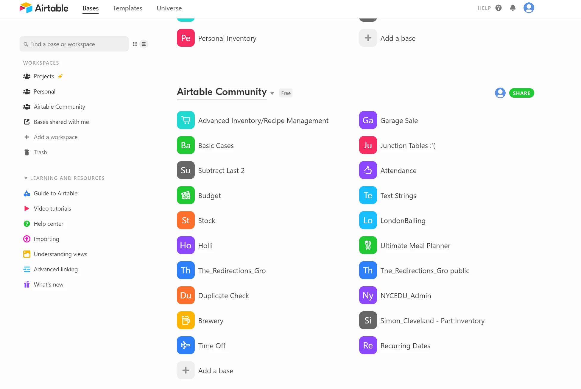

Oh okay. So when you log into Airtable you’ll see your “workspaces”, which are a collection of bases. In my case, I have a workspace called “Airtable Community” with 20 bases in it.
Each base contains tables. Therefore, you’ll need to select a base from your workspace to begin working. Since you already seem to have the Custom Blocks environment set up, that is the base you will need to open.
thanks @Kamille_Parks for responding. I have logged in to https://airtable.com/ but I did not see anywhere to create table as you screenshots. please help me may be with direct links on where to create tables… am new to airtable. thanks
Hey Fredrick,
You first need to create the base, then you need to create the table from within the base.
You can either use one of the templates that exist or create your own.
Once you do create a base, you’ll see the option Kamille pointed out, above
