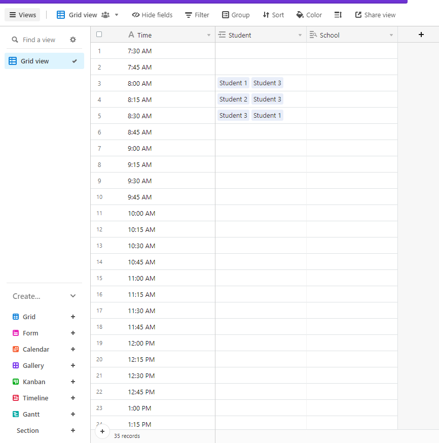

I have several linking records that involve student teachers, what school they are working in, and what times they are teaching. What I want to do is compare one student’s availability with another student’s availability.
I started with this:

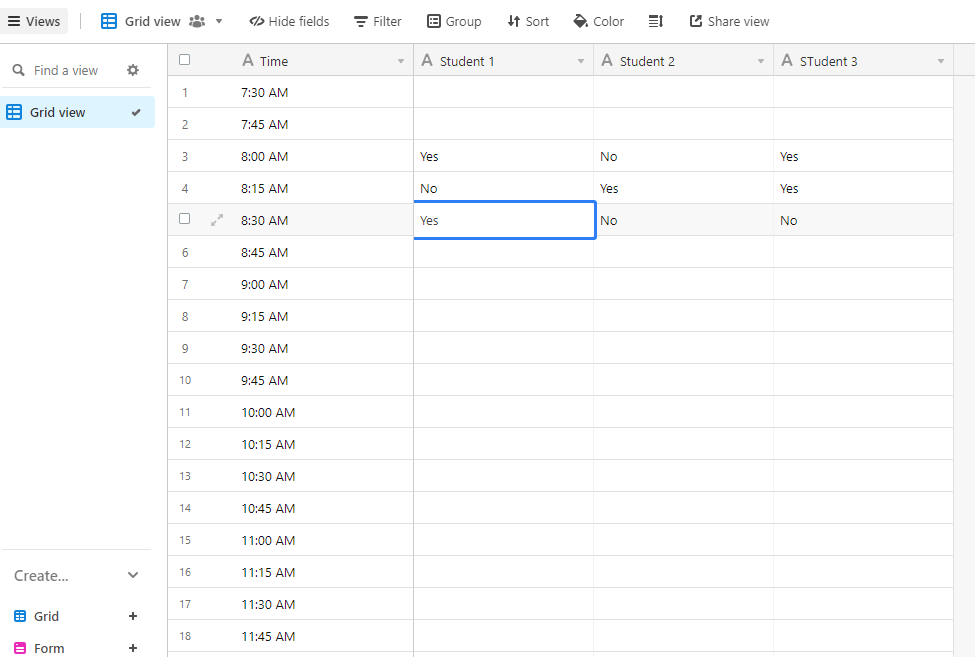

But I would like it to look something like :
I thought about using a formula on my first table to create the information :
IF(Student=“Student 1”, “Yes”, “No”)
However, that returns “No” for everything. How do I set this up so that I can compare two or three students’ availability while eliminating all the extra information? For instance, if want to compare student 1 or student 3, I don’t want to see student 2’s information. (I am actually dealing with 12 students on 5 different days.)

IF(FIND(“Student 1”,Student), “Yes”, “No”)
