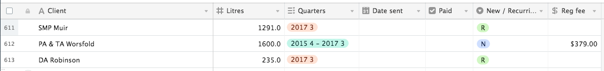

Hello,
I have a nested formula that works a treat, however I need to add on to it and I’m wondering if someone would have the expertise to help me.
Currently I have this;
IF(Litres<38,Litres0.66,IF(AND(Litres>=38,Litres<277),25,Litres0.09))
I have a whole other column called {reg fee} which I need the above IF formula to only be run if {reg fee} is NULL, and then IF the {Reg fee} = 379, and Litres is <750, then add 379 + Litres *.66, or if {reg fee} = 379, and Litres is >750, then add 379 + Litres *.9 *.66
Hope someone can help me make sense of this! Any help greatly appreciated

Hi
Maybe if you provide a screenshot of what you are trying to do it would be easier to help you. :slightly_smiling_face:

Hi
Hi - thanks for replying
here is what I am trying to do;
if the column {reg fee} = 379, then i need the formula to look at the litres column and if the litres are less than 750 then X the litres by 0.09 and X 0.66. If the {reg fee} is over 750, then look at the litres column and X the litres by 0.66
To make it more complex, I then need to add the 379, but I think the easiest way to do this is via another formula in another cell.

For the record, this was what the OP was asking for…
IF(AND({REG FEE} = 379, LITRES > 750), (LITRES * .09) + 379, 0)
