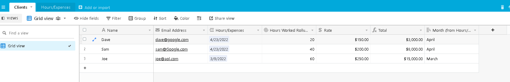

Here is my Client table layout:

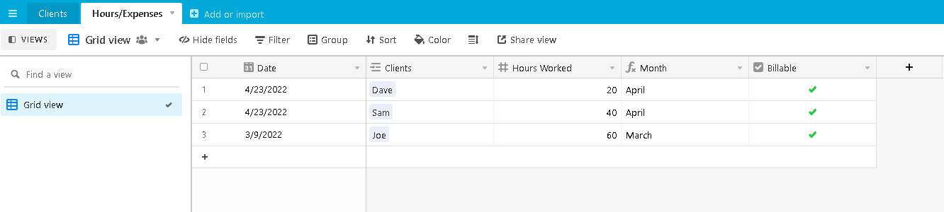

Here is my Hours Worked/Expenses Table:
Yours may be a little different but the basics are the same

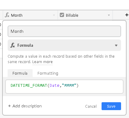

Here are the roll ups and formulas I used:
Get the name of the month from the hours/expense date
The Hours worked roll up in the Clients table. Notice the condition that Billable should be checked for it to roll up.
Now you can create a view for each month or a grouping to see the total for the month
The rest of the items should follow suit as the hours worked.
