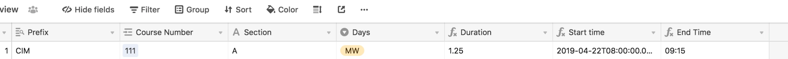

@JonathanBowen thanks for your answer. I am trying to create a spreadsheet to schedule classes. I was using at first.
SWITCH( Section, 'A', '8:00', 'B', '9:00' )
The only issue is that I have another field called duration and I am trying to calculate the end time for the class. To use the date functions I need them to be in H:mm format and not a string.

Figured it out. Ain’t pretty but works:
DATETIME_FORMAT(DATETIME_PARSE("8:00", 'hh:mm'), 'hh:mm')
  • April 20, 2019
Nope still stuck, when I try:
DATEADD({Start time}, 3, "hours")
it bombs.

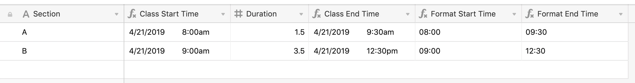

Hi @kim_g - yep this is because DATETIME_FORMAT outputs a string, which can’t then be used in any date/time formulas. How about this:
{Class Start Time} is the formula noted above:
SWITCH(Section,
'A', DATETIME_PARSE('8:00', 'HH:mm'),
'B', DATETIME_PARSE('9:00', 'HH:mm')
This is now outputting as a date/time, although as you can see it is displaying the date element (which shows today’s date).
Your {Duration} is simply an integer. The {Class End Time} field is a formula that adds the duration onto the start date/time:
DATEADD({Class Start Time}, Duration, 'hours')
Now that you have the start and end times as date/times you can format both and only display the time elements (last two columns) using:
DATETIME_FORMAT({Class Start Time}, 'HH:mm')
DATETIME_FORMAT({Class End Time}, 'HH:mm')
The Class Start Tie and Class End Time fields can be hidden if you don’t want to see them.
What we’re doing here is:
Date formulas, then date display
rather than
Date display, then date formulas
Does this give you what you want?
JB

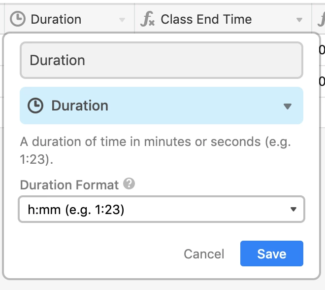

Hi @kim_g - yes, figured it out. You need to set the duration field to be a “duration” rather than an integer (lol, I should have thought of that :winking_face: ):
So you can now enter this is 1:15 for one hour 15 mins etc.

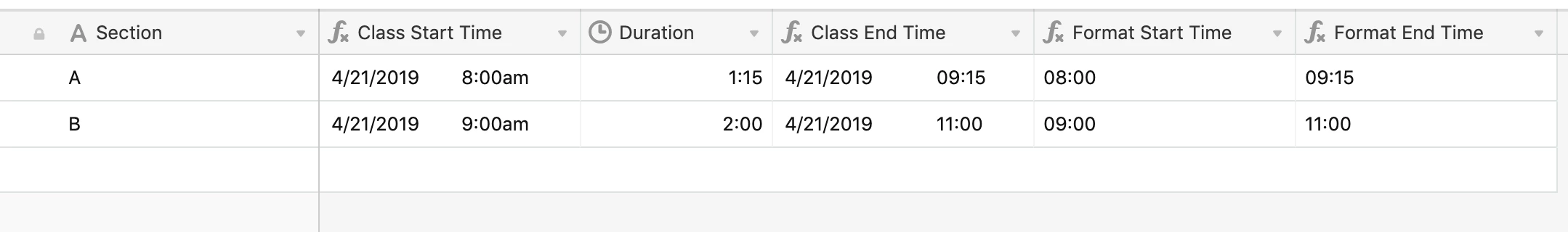

Then on the {Class End Time} set the formula to be:
DATEADD({Class Start Time}, Duration, 'seconds')
When you use DATEADD() and a duration field, the units always needs to be 'seconds'.
So, now, you end up with:
JB
