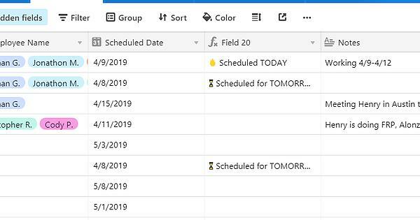

I’ve searched, googled and tried all the formulas I’ve found and nothing is working. I feel like I’ve spent more time working on these dang formulas than the table itself. Any help is greatly appreciated. Also, if anyone knows anywhere I can test a formula or understand what each means in the order it should be would be a huge help. I just don’t understand Airtables examples (its just words…no way of linking) which is where I think I am failing.
I have a scheduled tab with dates (no times) for upcoming projects. I’d like to have a formula that shows if the date is today - the formula reads - DUE TODAY.
if the date is within a week - Due next week
If its due in 1 day - due tomorrow
If its past due - Past due.
I know its simple, but again - I loose it on the commas, parentheses and quotations. Maybe if i can figure this out with some help I can add some emojis.
Thank you.

Ok I’ve tried with everything I know but still not getting this right. Based on your example and the change of the ‘date’ wording to match my cells - its showing due for tomorrow for yesterday’s date? How can I fix this? What about dates that are scheduled further in advance? I tried a formula for those and they all turn past due…?
  • Apr 9, 2019 8:11 PM UTC
Can you share the formula you are using?
IF(IS_SAME(TODAY(), {Scheduled Date}), “ :fire: Scheduled TODAY”, IF(DATETIME_DIFF(TODAY(), {Scheduled Date}, ‘days’) = 1, “ :hourglass_flowing_sand: Scheduled for TOMORROW”, IF(DATETIME_DIFF(TODAY(), {Scheduled Date}, ‘days’) =7, “ :stopwatch: NEXT WEEK”, IF(IS_AFTER(TODAY(), {Scheduled Date}), “ :tired_face: Past Due”))))

I fixed the <=7 and I’m still having the same issue. It seems dates scheduled on the 4th are scheduled for next week - when they are actually past due (marked done by checkmark)
Here is the formula I’m using https://imgur.com/LIlQbMK
IF(IS_SAME(TODAY(), {Scheduled Date}), "🚚 Scheduled TODAY 🚚", IF(DATETIME_DIFF(TODAY(), {Scheduled Date}, 'days') = 1, "⏳ Scheduled for TOMORROW ⏳", IF(DATETIME_DIFF(TODAY(), {Scheduled Date}, 'days') &lt;=7, "👀 NEXT WEEK 👀", IF(IS_AFTER(TODAY(), {Scheduled Date}), "😫 Past Due 😫"))))```

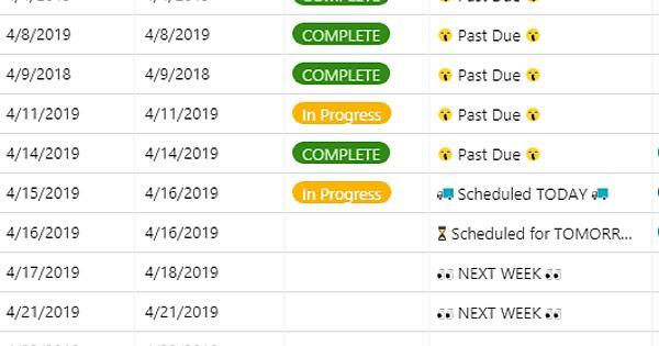

Ah, I forgot to update my question - I’ve removed the checkbox because it seemed redundant to have a status (single select) and a check box. My single select options show ‘Complete’, ‘In Progress’, ‘Need to reschedule’. I’ve tried manipulating the formula to show the single select option but I continue to get errors.
What I’m trying to accomplish is -
rather than the formula showing past due on those marked ‘complete’ it says “All Done” or just blank.

That’s how I changed it before I asked and I’m still getting an error message? Status is the name of my field. :slightly_smiling_face:
IF(Status= "COMPLETE",

You’re missing a closing parenthesis at the end. After the Next Week output string, you have four closing parentheses. You should have five.
Stuff like that is tricky to track, which is one of the reasons I follow the example of some other folks here and use a separate text editor when constructing more complex formulas. :slightly_smiling_face:
  • Apr 15, 2019 7:31 PM UTC
Yes!!! Thank you. You have been a huge help, not only just giving me the formula but providing instructions and explanations as well.

  • Feb 22, 2024 8:18 AM UTC
After a quick play, I found a few problems:
  1. The order of the checks makes a difference. The order that I found to work consistently is Past Due first, then Today, then Tomorrow, and finally Next Week (i.e. chronological order)
  2. In order for {Scheduled Date} to compare correctly against TODAY(), the latter had to be forced into the correct time zone, which involved turning every TODAY() in your formula into:
    DATETIME_FORMAT(SET_TIMEZONE(TODAY(), "America/Chicago"), "M/DD/YYYY")
  3. Your DATETIME_DIFF functions had the first two items reversed, leading to negative numbers, so the some comparisons didn’t return the results you expected.
The final modified function that I was able to test successfully for all states is this:
    IS_AFTER(
        DATETIME_FORMAT(
            SET_TIMEZONE(
                TODAY(),
                "America/Chicago"
            ), "M/DD/YYYY"
        {Scheduled Date}
    ), "😫 Past Due 😫",
        IS_SAME(
            DATETIME_FORMAT(
                SET_TIMEZONE(
                    TODAY(),
                    "America/Chicago"
                ), "M/DD/YYYY"
            {Scheduled Date}
            DATETIME_DIFF(
                {Scheduled Date},
                DATETIME_FORMAT(
                    SET_TIMEZONE(
                        TODAY(),
                        "America/Chicago"
                    ), "M/DD/YYYY"
                'days'
            ) = 1,
                DATETIME_DIFF(
                    {Scheduled Date},
                    DATETIME_FORMAT(
                        SET_TIMEZONE(
                            TODAY(),
                            "America/Chicago"
                        ), "M/DD/YYYY"
                    'days'
                ) <= 7,
                "👀 NEXT WEEK 👀"
You’ll need to adjust the timezone setting for your local area, of course.
If you want to condense things a bit, you could make a formula field that just does the TODAY time zone force using that one-liner I listed above (again adjusted for your local time zone), then reference that field wherever it needs to occur. I made such a field called {Today}, which let me shrink the main formula down to this:
    IS_AFTER(
        Today,
        {Scheduled Date}
    ), "😫 Past Due 😫",
        IS_SAME(
            Today,
            {Scheduled Date}
            DATETIME_DIFF(
                {Scheduled Date},
                Today,
                'days'
            ) = 1,
                DATETIME_DIFF(
                    {Scheduled Date},
                    Today,
                    'days'
                ) <= 7,
                "👀 NEXT WEEK 👀"

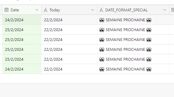

Hi
first of all thank you for your help.
using your formula I noticed a small error it is Thursday 02/22/2024 so normally Saturday 02/24/2024 and Sunday 02/25/2024 should be displayed as this week not next week
I think this problem is just for Saturday and Sunday.
the week normally starts from Monday to Sunday
