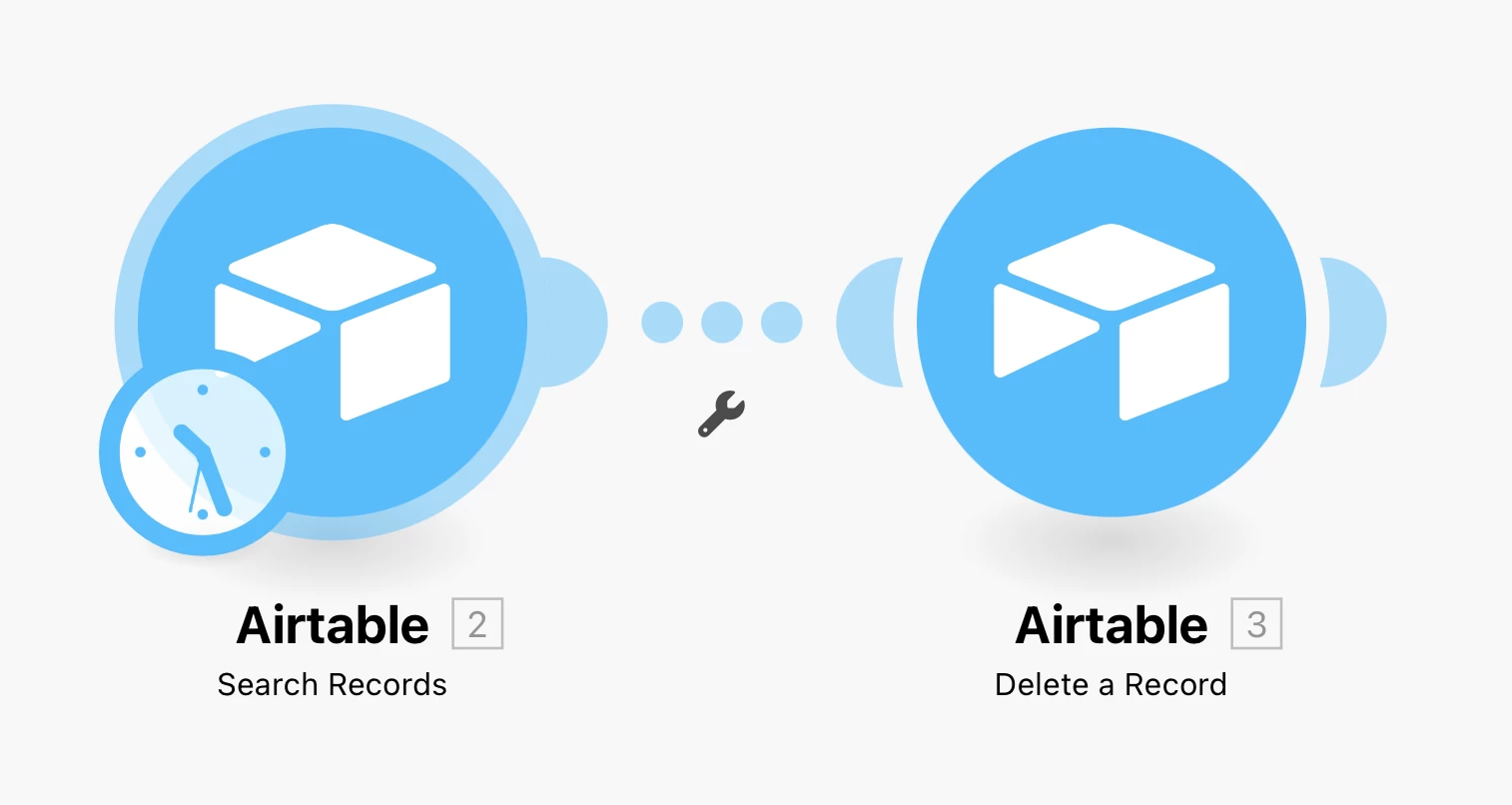

Also, for those people reading this thread in the future who want a no-coding way of deleting all records at once, below is a screenshot of how you would set this up in Make.com.
Just tell Make to search for all of your records (by using the formula: 1), and then Make will delete all of your records.
Thank you! more than 2 years later I found your answer very helpful!
