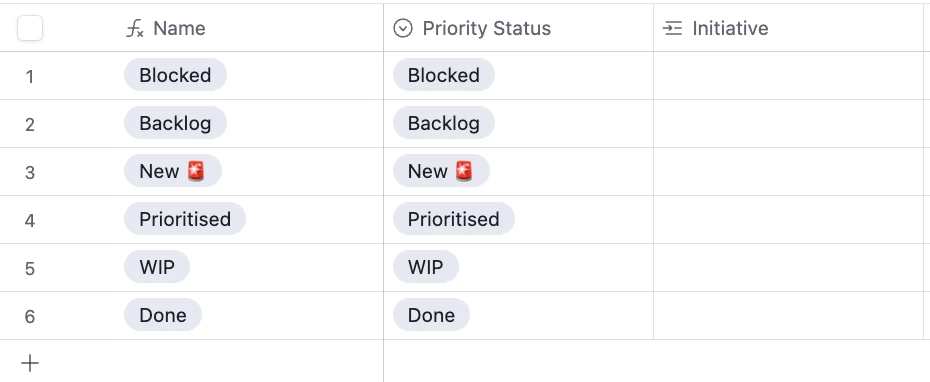

  3. The newly created “Initiative Status” table is relatively simple
You just need three fields
  •  Name (Formula)
  • Priority Status (Single Select) - All the options should be exactly the same as the options in the main initiatives/projects table.
  • Initiative/Project (A linked record field to your place for main initiatives/projects)
Formula is super simple, {Priority Status} and in the formatting tab, toggle on the “Change formula output to single select options”. This is optional, btw. If you want you can display this as a text, I prefer when status is displayed as an option.

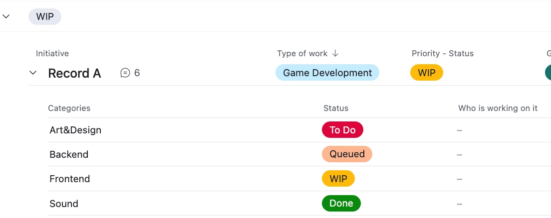

 Then add a hierarchy levels into your interface page
1 Level: Initiative/Project Status
2 Level : Initiatives/Projects
3 Level: Type of work/Milestones/Components
Result nicely grouped records with visible milestones.
