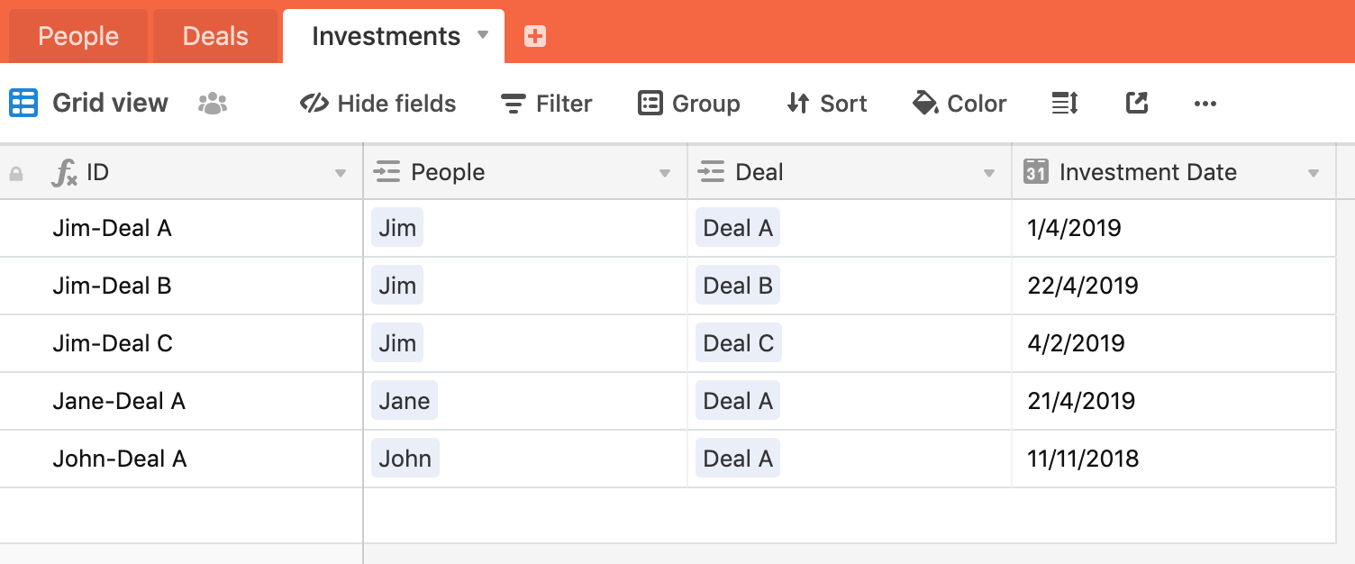

Hi @Peter_Steinberg - if this is your Investments table:

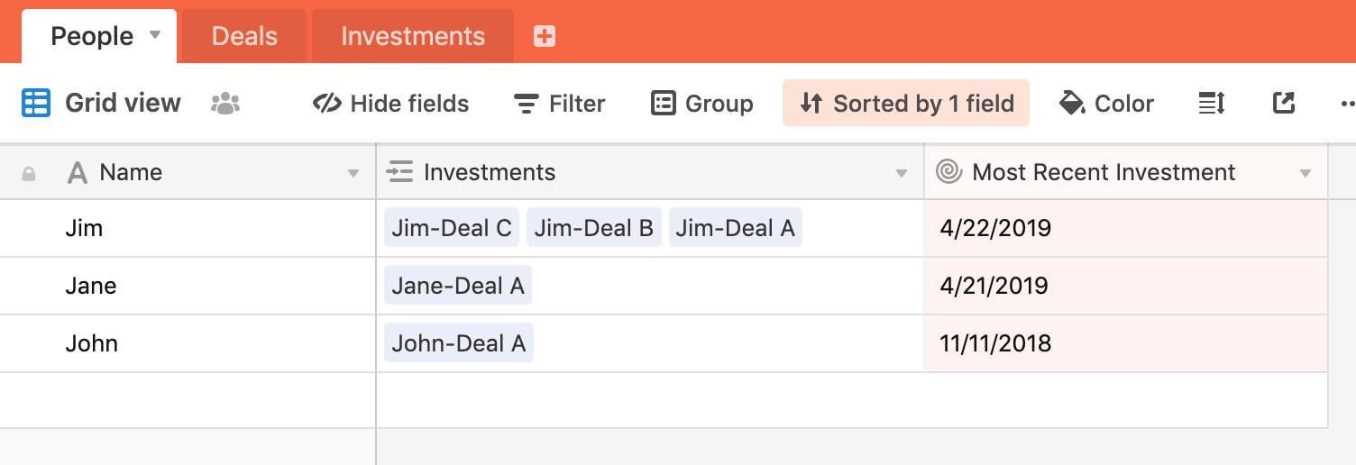

Back in your People table you will have this:

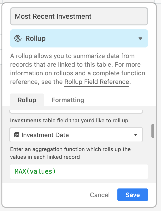

The {Most Recent Investment} field is a rollup formula:
So, a rollup of the {Investment Date} field from the Investments table using MAX(values)
You can then sort by the rollup field.

This did the trick. You’re the best. Thanks!
(I knew of the Rollup field type – I just didn’t recall that you could apply functions to the results.)
