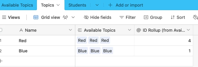

I created a "Topics" where I linked the records from the "Available Topics" field appropriately:

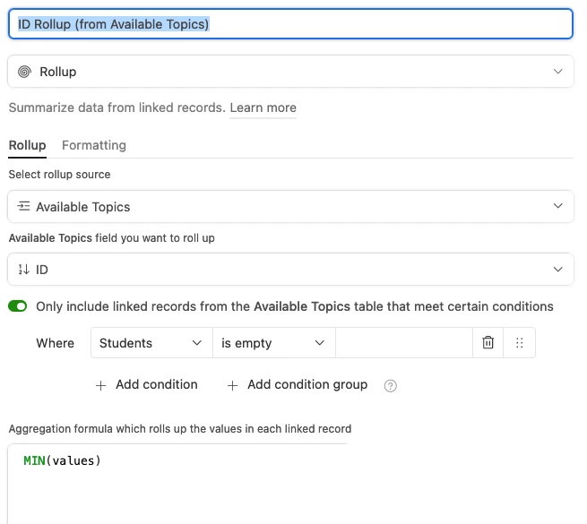

I also created an "Autonumber" field in "Available Topics", and then created a rollup field in "Topics" with the formula "MIN(values)", as well as a conditional to only include the records where the linked field to "Student Reservations" was unlinked:

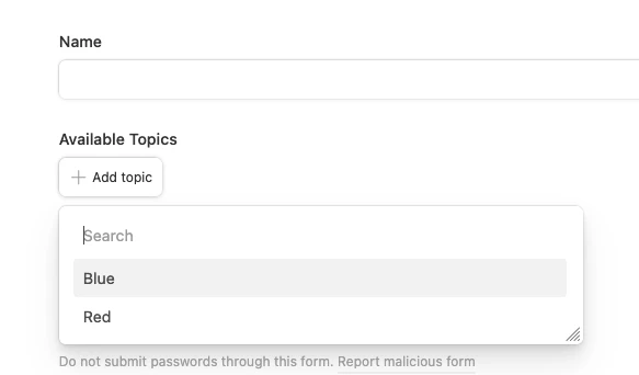

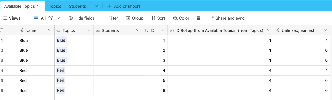

In "Available Topics", I then created a lookup field to display the value from the previously mentioned rollup field, and then created a formula field to check the lookup field value against the autonumber field value.  In the Interface form, I gave it a condition to only display records where the formula field's output is "1"
Sounds super complicated but it's fairly easy to set up and should work like you want! 
