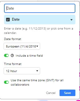

Thank you for your reply. I don’t see a formatting tab - I have attached a screenshot of what I see after selecting ‘customise field type’
I can see the basic formatting options ( there are about 4 ways to display the date/time) but what I want to do is not there. Ideally I would like to use format such as this example - Mon 01 April 2018, 2:30pm. I can see this can be done with formula, but can’t find a way of getting this kind of format without it being the result of formula linked to another column.

No, you’re right; for some reason I thought you were dealing with a calculated date (that is, a formula field that evaluates to a date) rather than a data entry date field.
You’re also right in that your choices are limited; the date field doesn’t support the full range of options available through DATETIME_FORMAT(). I’m afraid that is your only route if you’re determined to use that specific format.

On behalf of the folks at Airtable, given the large number of possible variations in the way a time/date field could be formatted, I understand the line must be drawn somewhere. (For what it’s worth, most of the time the integral formats don’t satisfy my needs, either.)
