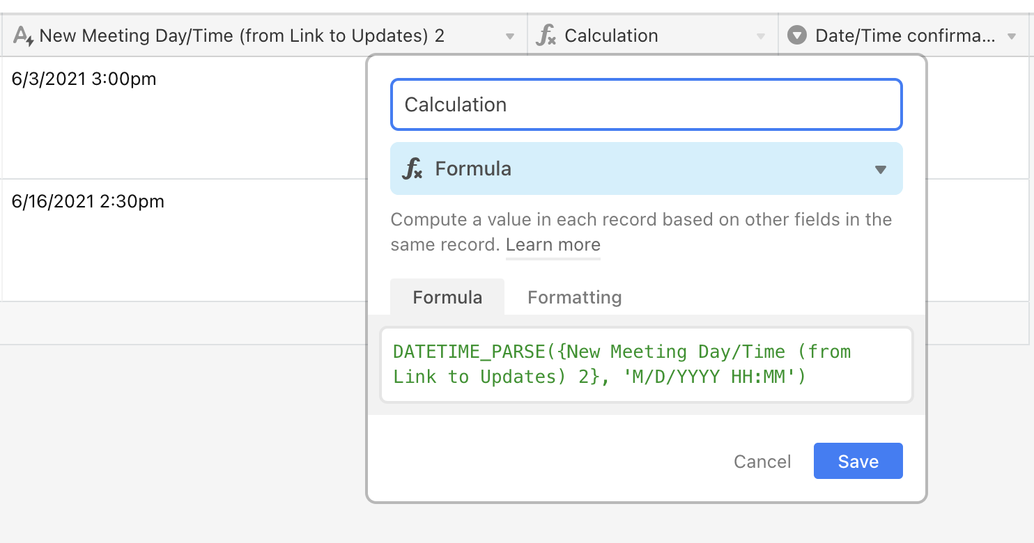

That is exactly how I set it up.
See attached and I get an error.

Try using the DATETIME_PARSE() function without any arguments (just the variable itself inside the parentheses).
  • May 28, 2021 5:02 PM UTC
Still an error.
DATETIME_PARSE({New Meeting Day/Time (from Link to Updates) 2})
Forum|alt.badge.img+10
  • May 29, 2021 2:13 AM UTC
Still an error.
Sorry this is so annoying. Hopefully this will work:
DATETIME_PARSE({New Meeting Day/Time (from Link to Updates) 2}, "M/D/YYYY h:mma")
My Hero! Thank you so much!
