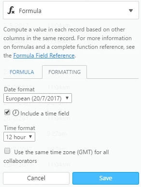

Thanks @W_Vann_Hall That’s much neater! And we can format differently via the Formatting tab.
Voila! :thumbs_up:
Voila! :thumbs_up:
