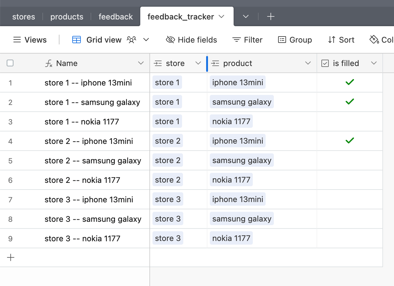

One way to achieve this is to create additional table with rows created beforehand for each store and product. For example, if you have 3 stores and 3 products, this table would contain 3*3 = 9 rows.
Here is an example of such table:
Then you create an Automation that gets triggered every time a new feedback is created. This  automation would find the record for this "feedback_tracker" table and set 'is filled' checkbox to true.

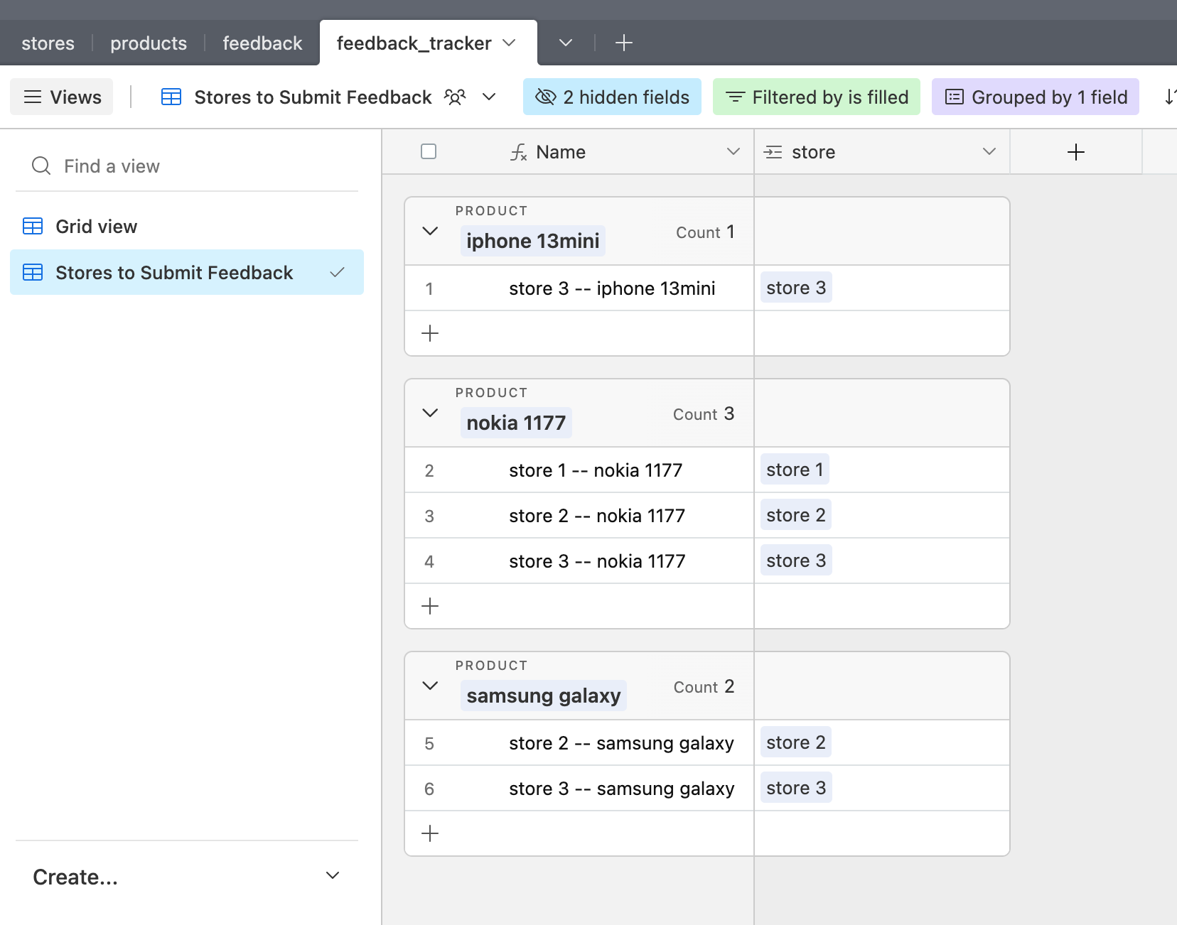

Then, create a Grid View at 'feedback_tracker' table that would filter out records where 'is filled' is not checked.
The result would look like this:
Hope this helps
