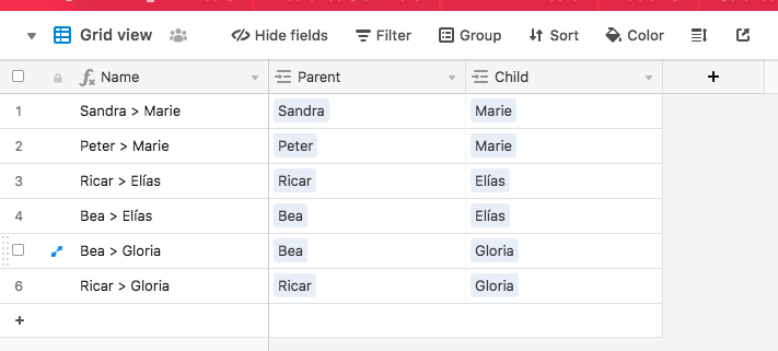

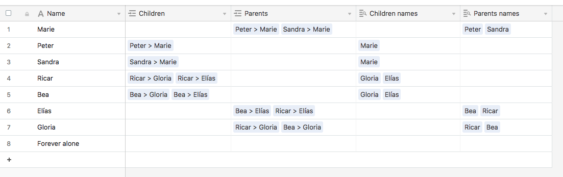

I think you need an extra Table (maybe Parenthood), because you can’t get the number childs from the same table, I mean with a Lookup.
An example
People:
Relations:

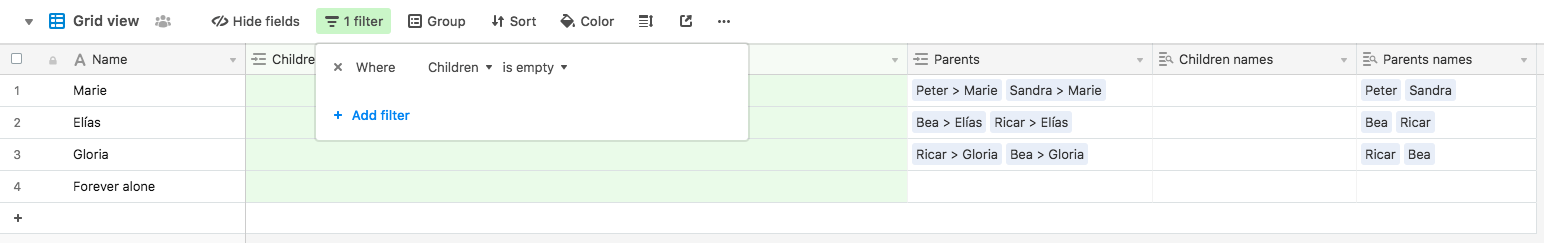

And then you could create a View with the desired Filter:

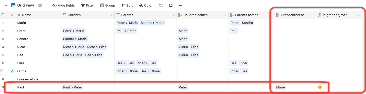

@Elias_Gomez_Sainz I just noticed a thing while recreating your example.
Are these steps correct?
(1) adding Marie, Peter, Sandra in People table
(2) adding Sandra > Marie and Peter > Marie records in Relations table
(3) modifying parents field of Marie in People with a reference to records Sandra > Marie and Peter > Marie
(4) modifying children field of Peter and Sandra in People, adding a reference to Sandra > Marie and Peter > Marie
I feel there’s duplication of information while performing steps 3 and 4, because the relationship between these three people is already expressed in step 2.
This could lead to inconsistencies in information stored in the database if someone makes a mistake or forgets steps 3 and 4.
Am I forgetting something?

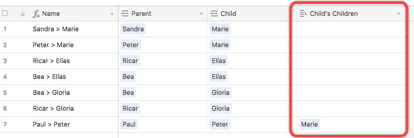

Airtable allows lookups on self-joins now:
This should eliminate the need to perform steps 3 and 4 above. Instead, perform a lookup One way or the other, either to see who the parents are (if you joined children to parents), or to see who the children are (if you joined parents to children).
