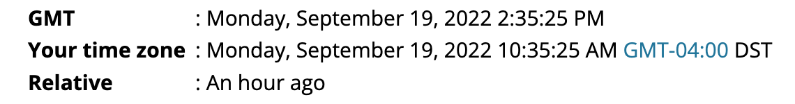

I can’t seem to figure out why that is. I checked the UNIX timestamp online and it shows me the correct converted date

OK, i played around with it a little more.
Your time stamp is in milliseconds. to change your original formula to:
DATEADD('1/1/1970',_eventTimestamp,'ms')
An you should get the date: 9/19/2022 2:35pm
