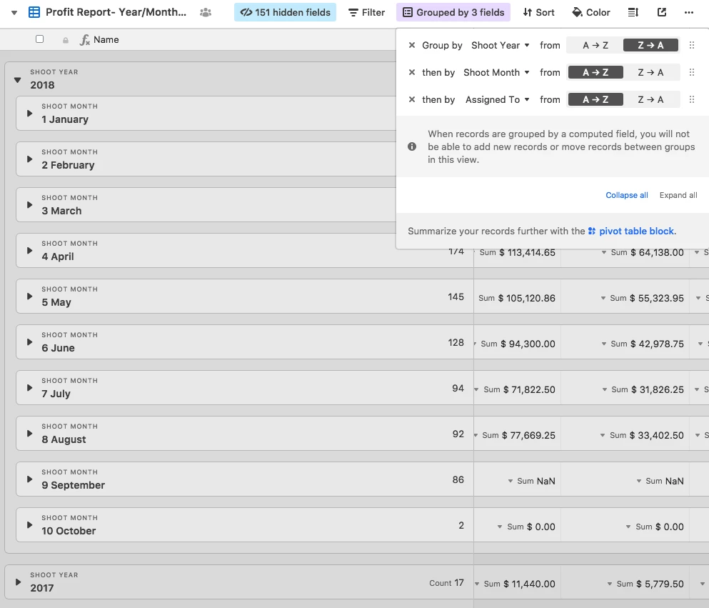

Use the Group menu to group by the “Year” field (order from Z -> A if you want the most recent reads at the top):
(as you see from the screenshot, you could take this a step further and break them down into months as well - ask later if you want help with that)
This will allow you to see create summaries by year - the summary bar lets you Sum, Avg, etc the values of any records within the group (Year group) on the fields below - so you could see the Sum pages read by year, for example, and at the very bottom of the page, you can see Sum pages read for ALL years.

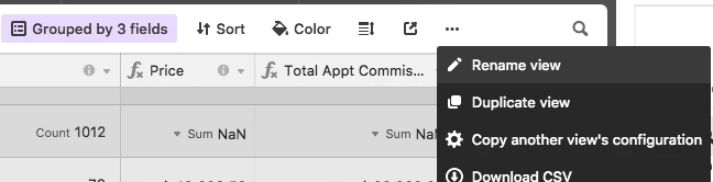

Rename that view to “Grouped by Year” or some-such:

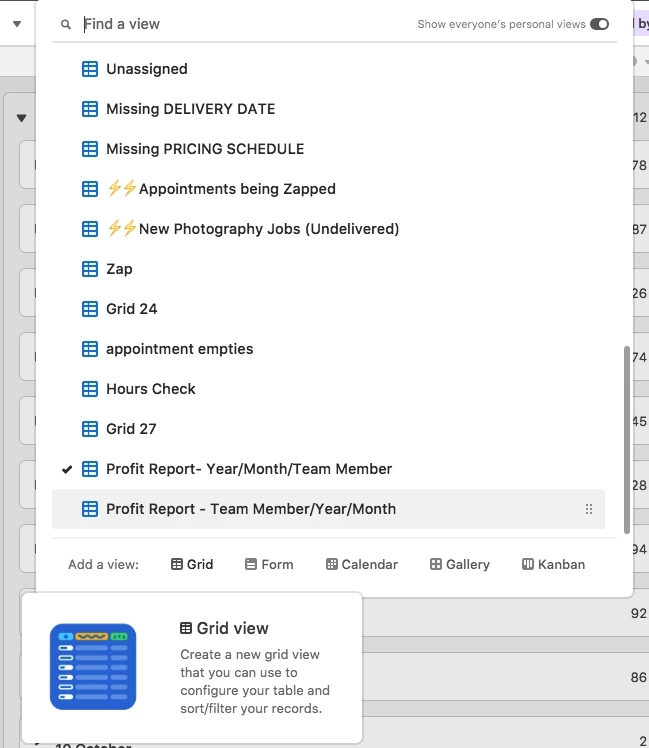

Make a new grid view to Group by Genre:
(follow grouping steps above, but choose your “Genre” field to group on)
In that “View” you can see your Sum or Avg, etc values by Genre group.

Play around with nesting groups - Group first by year, then by Genre, then by Type (book vs audio) etc…
In Airtable, you want to keep your data as unified as possible - don’t split up records that look essentially the same into different tables (ie, Year). Make the “Year” an attribute within a record. Then, utilize “Views” to filter/group/sort your data as you want to see it.
