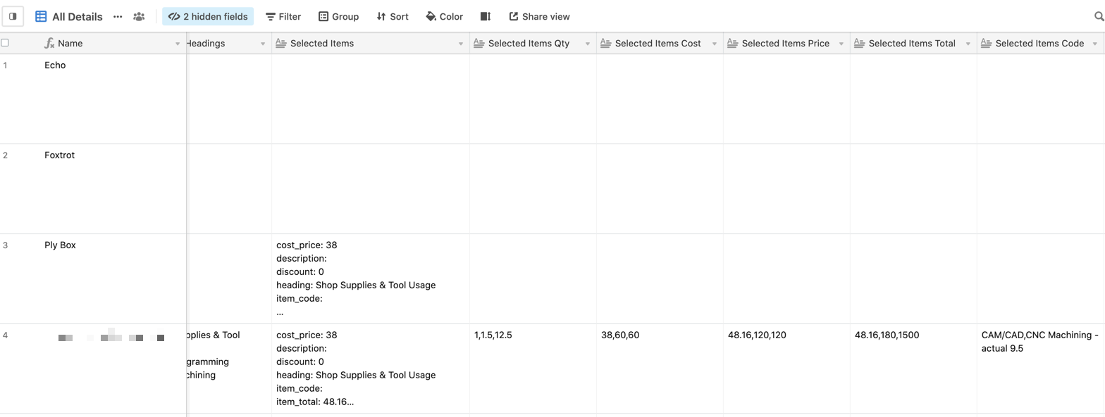

Hey all. I have a similar challenge I’d love some help with. I’m dumping in this data below from Zapier into a field called {Selected Items}:
Selected Items
description:
discount: 0
heading: Shop Supplies & Tool Usage
item_code:
item_total: 49.16
quantity: 1
sales_category: Materials & Supplies
subscription:
tax_description: No tax
tax_rate: 0
unit_price: 49.16
description:
discount: 0
heading: CNC Programming
item_code: CAM/CAD
item_total: 210
quantity: 1.5 :point_left:
sales_category: CAM/CAD Design
subscription:
tax_rate: 0
unit_price: 140
description:
discount: 0
heading: CNC Machining
item_code: CNC Machining - note
item_total: 1750
quantity: 12.5
sales_category: CNC Routing
subscription:
tax_rate: 0
unit_price: 140
I’d like to pull out the quantity amounts into their own field. So for example I have created a new field with the name, “CAM” and I’d like that to result in just 1.5 from under the heading CNC Programming
I’m struggling to come up with the right LEFT/RIGHT/SEARCH combination that gets me just the quantity for that lookup.

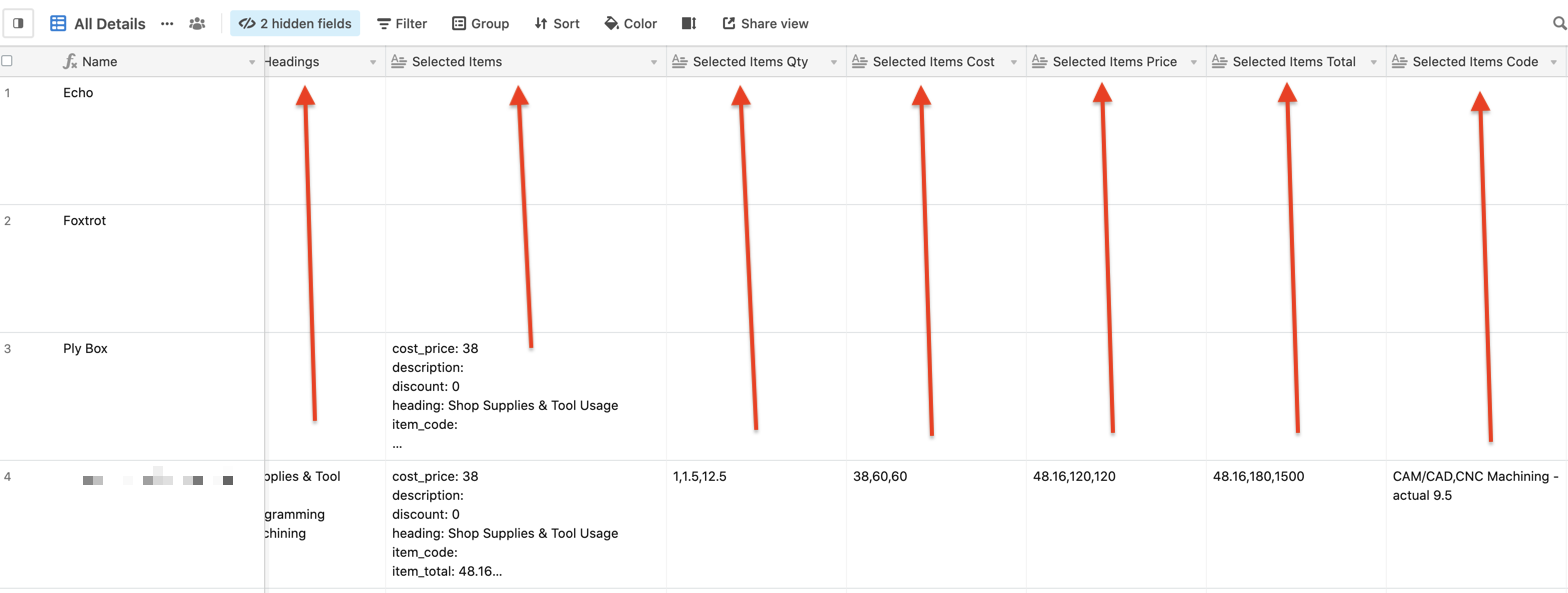

Where is this data coming from before Zapier gets it? I’m inclined to find a way to separate it earlier in the process, as a formula to isolate the quantities for different fields would be cumbersome at best. It looks like you’ve effectively got an array of dictionaries/objects. Do you want the other items (description, discount, item total, etc.) to also end up in their own fields, or do you only care about the quantity?
  • Oct 21, 2020 6:34 PM UTC
Hey. It’s coming from Quotient.
I’m having it dump in all the “Selected items” data but it comes in in an array that’s fairly unhelpful - at least to my coding skillset.
Here’s an example of what Zapier dumps in from Quotient.
Is the {Selected Items} field the only one being updated by Zapier? In the other fields in your screenshot, I see values for quantity, items cost, etc. Are those also from Zapier, or did you pull those out manually?
  • Oct 21, 2020 7:24 PM UTC
Every field in this screenshot comes from Quotient to Zapier. The names are very close.
Here is everything that is dumped from Quotient to Zapier in this example:
event_name
quote_accepted
quote_number
18770
title
##-###-R## Job Name
quote_url
https://go.quotientapp.com/q/UNIQUE-STRING
from
My Company
for
Their Company
first_sent
2020-10-09T01:54:23+00:00
valid_until
2020-11-08T01:50:00+00:00
quote_status
Accepted
is_archived
false
currency
USD
amounts_are
No Tax
overall_discount
0
quote_for
name_first
Customer
name_last
Surname
email
customer@email.com
company_name
Their Company
phone
type
Primary Phone
value
(555) 555-5555
address
type
street
city
state
zip
country
item_headings
CNC Programming
CNC Machining
total_includes_tax
1728.16
total_excludes_tax
1728.16
discount_amount_includes_tax
0
discount_amount_excludes_tax
0
selected_items
0
item_code
heading
description
sales_category
tax_rate
0
tax_description
No tax
subscription
discount
0
cost_price
38
unit_price
48.16
quantity
1
item_total
48.16
1
item_code
CAM/CAD
heading
CNC Programming
description
sales_category
CAM/CAD Design
tax_rate
0
tax_description
No tax
subscription
discount
0
cost_price
60
unit_price
120
quantity
1.5
item_total
180
2
item_code
CNC Machining
heading
CNC Machining
description
sales_category
CNC Routing
tax_rate
0
tax_description
No tax
subscription
discount
0
cost_price
60
unit_price
120
quantity
12.5
item_total
1500
accepted
accepted_on_behalf
false
accepted_on_behalf_who
order_number
comments
when
2020-10-09T02:12:26+00:00
by
name_first
Customer
name_last
Surname
email
customer@email.com
company_name
Their Company
phone
type
Primary Phone
value
(555) 555-5555
address
type
street
city
state
zip
country
Thanks for the clarification. It looks like the values you want are already there. The {Selected Items} field shows all of the relevant details for each item, while the other fields to the right break down specific pieces of those items. In your initial message you said that you wanted the quantity. There were three item lists, with the respective quantities being 1, 1.5, and 12.5. If you look in the {Selected Items Qty} field in your screenshots, you’ll see:
1, 1.5, 12.5
Do you want to extract one specific quantity (i.e. just the second item), or do something with all of the quantities as a group? If it’s the latter, that will require a script because they’ve been transformed into a single string, and Airtable formulas can’t (yet) parse strings with that much precision. However, if it’s just a matter of extracting a specific number, that can be done if you could share more info on how to identify the number you want.
