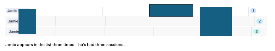

I have a table with a client session log adding a new record for each client when they have another session:
I would like to be able to show how many sessions each client has had (eg the maximum number of sessions). In this case for Jamie it will show 3.
I want to be able to bring the name and number of sessions into a report - Jamie - 3, Siobhan - 2, as a list.

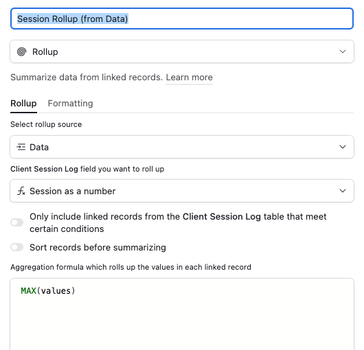

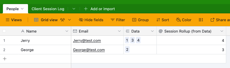

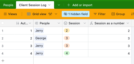

For anyone that stumbles across this thread in the future, you can do this by adding a formula field to convert the select field value into a number:
And then in your main table creating a rollup field with “MAX(values)” as the formula:
