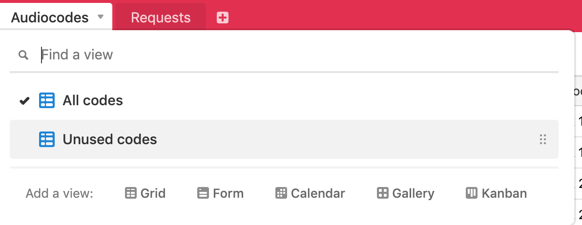

The Audiocodes table has two views:
The Requesters table has a link to Audiocodes (based on the view “Unused codes”).

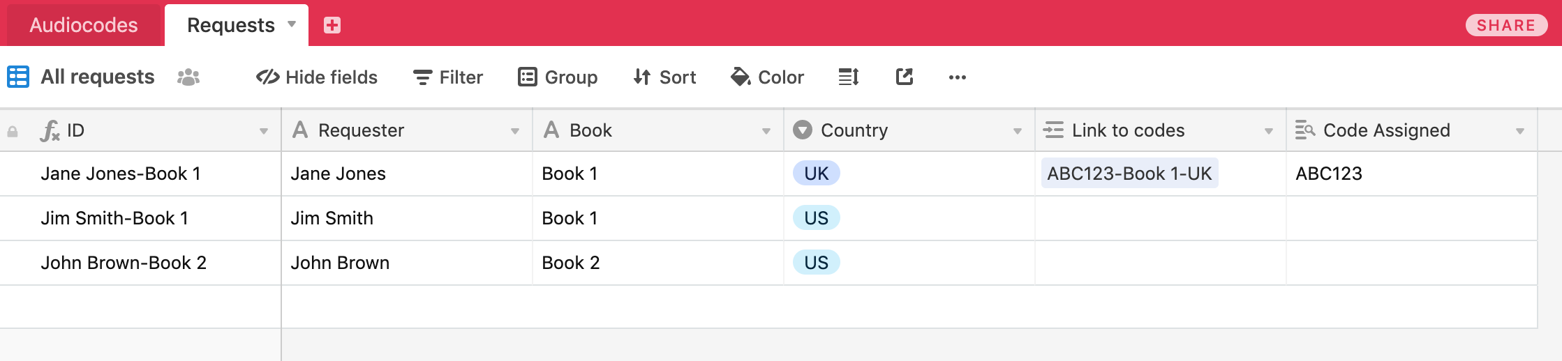

  1. Requester makes request via your form and populates the Requests table with Name, Book and Country.

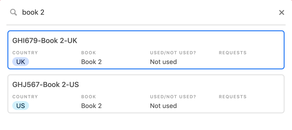

  2. For an open request, you click on the {Link to Codes} field and this will show only unused codes. I’ve put the book name and country in the ID for the Audiocodes table as this will allow you to search by book name (and country):
  3. You select the code you want to apply to this request - the {Link to Codes} field is populated and for ease of reading the code itself is pulled through via a lookup.

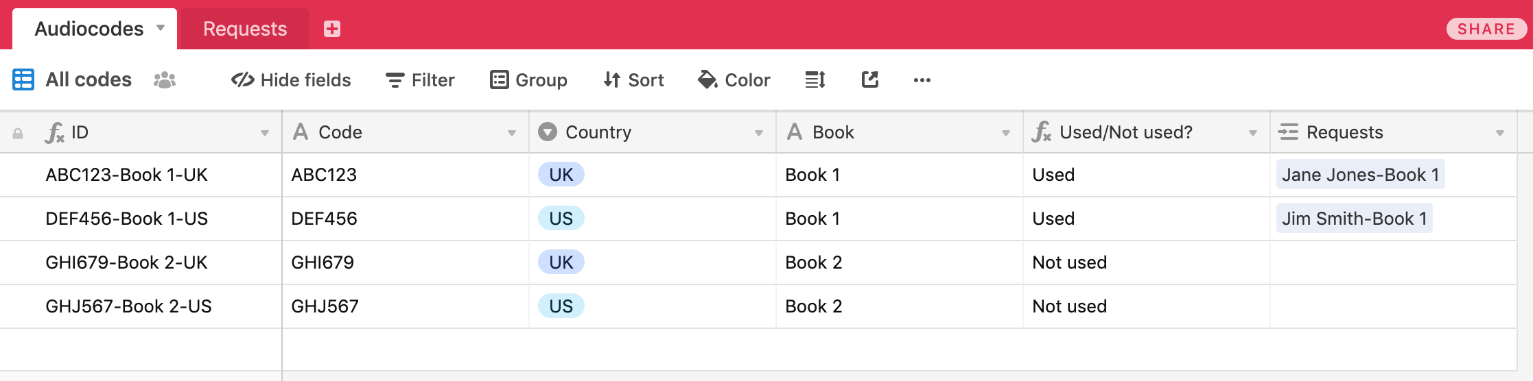

  1. Back in the Audiocodes table, your selected audiocode record is now flagged as “Used”:
and will no longer be available to select in the Requester table look-up.
