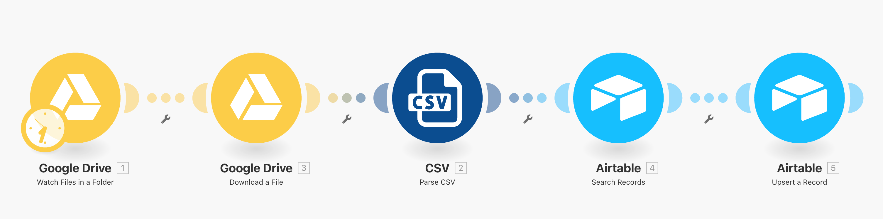

1. After parsing a row from the CSV (but before creating the new record in Airtable), you would need to use Make's Airtable automations & integrations to perform a search of your Airtable base. Then, you will have the Record ID to use for the Upsert module.
2. Take a look at the screenshot below to see how this might look.
3. I demonstrate this entire scenario in complete step-by-step detail on this Airtable podcast episode.

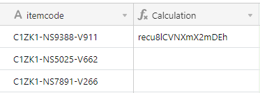

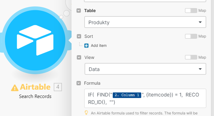

Thx for advice. I am trying to achieve this but so far without success.
I was able to create formula that works when I use it in Airtable. It will find the Record ID based on our code.
So something like this:
  FIND("C1ZK1-NS9388-V911", {itemcode}) = 1,
  RECORD_ID(),
That works in Airtable:
In Make.com I am trying to use it in “Search Record”:
But the Output doesn’t give me Record_ID:
So than I have no idea how to use then in Upsert…
Any advice?
Thnak you very much

You would only use the very small FIND section of your formula, without the equals 1 part.
However, aren’t you matching full item codes? You’re not searching for a subset within the item code. If so, your formula would simply be:
"2. Column 1" = {itemcode}

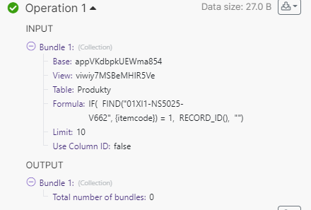

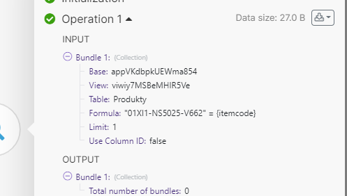

I tried id also first time. But the result is basically the same. No outcome of ID that I could use.
  • Jul 27, 2022 9:51 AM UTC
If there is no outcome, then there were no matching records in your base.
  • Jul 27, 2022 9:53 AM UTC
I am sorry Scott. I was dumb. The outcome looks like blank, but is not. And can be used in next “bubble” scenario step. :slightly_smiling_face: So your suggestin really works. Thank you very much! :slightly_smiling_face:
