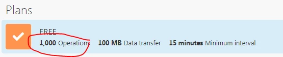

Integromat has a free limit of 1000 operations per month as opposed to Zapier’s 100. This is a major benefit for keeping our non-profit organisation’s database current.

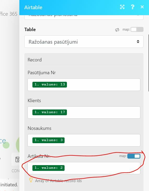

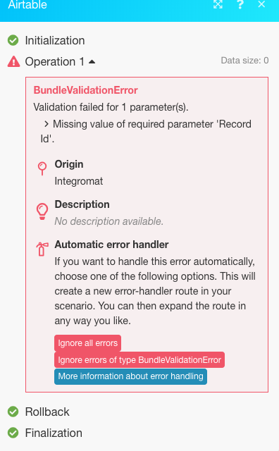

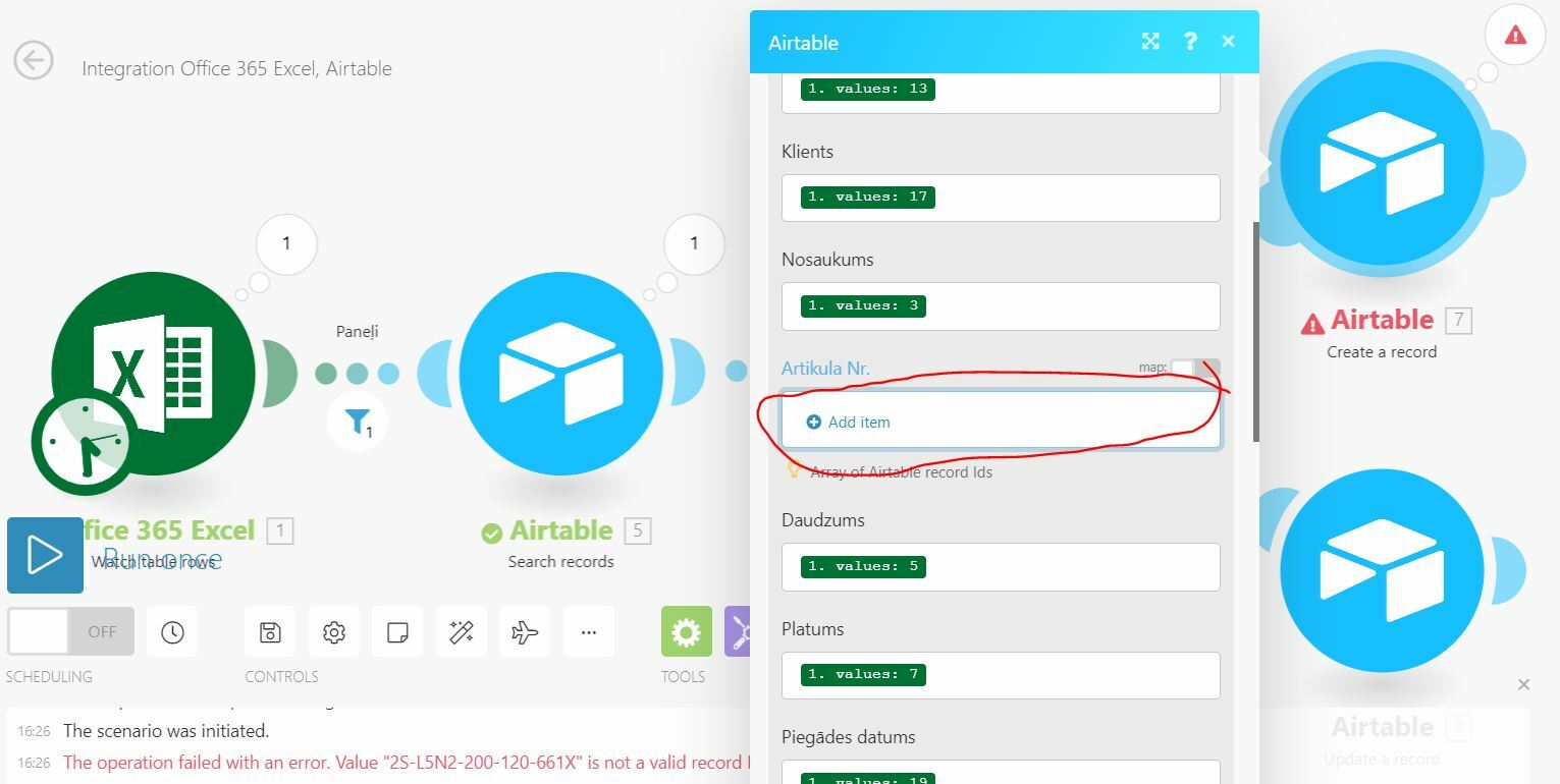

Trying to set up Integromat integration for new row in excel table to new record in Airtable. The fetching of records from excel works but I get an error “Value “null” is not a valid record ID.” on Airtable side and can’t understand what I’m doing wrong.
Help?
Forum|alt.badge.img+20
  • Sep 25, 2019 7:58 AM UTC
Help?

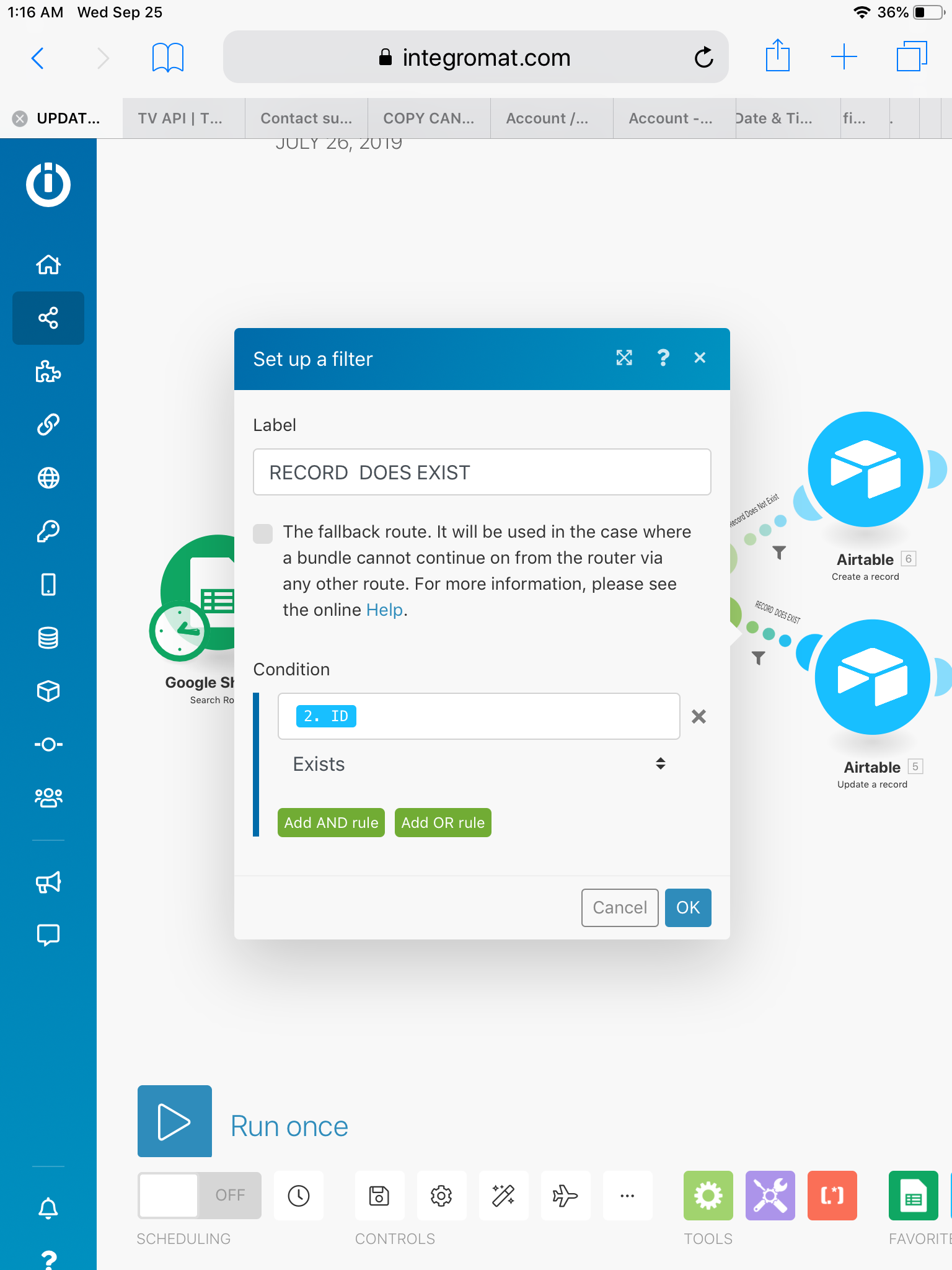

Hi @Krisjanis_Dzalbe1
Do you have some screenshots of the whole scenario? Also, the individual modules that you are using?
It might help.
Thank you,
Mary K

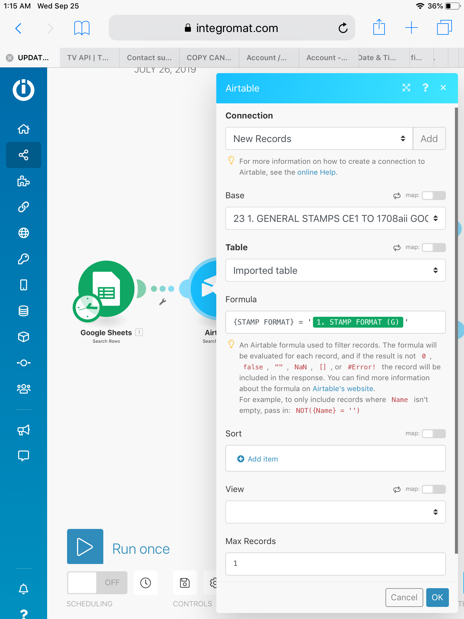

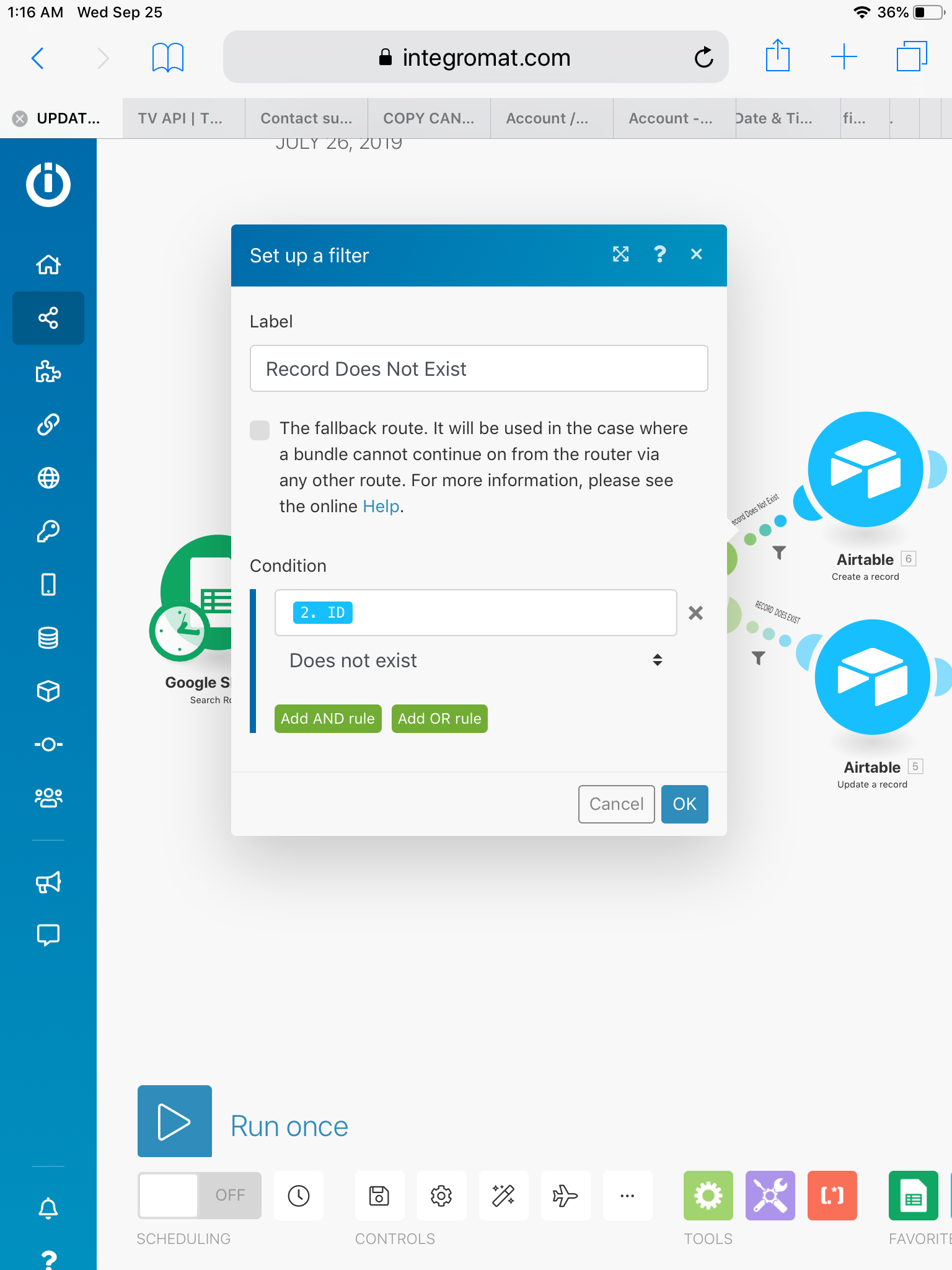

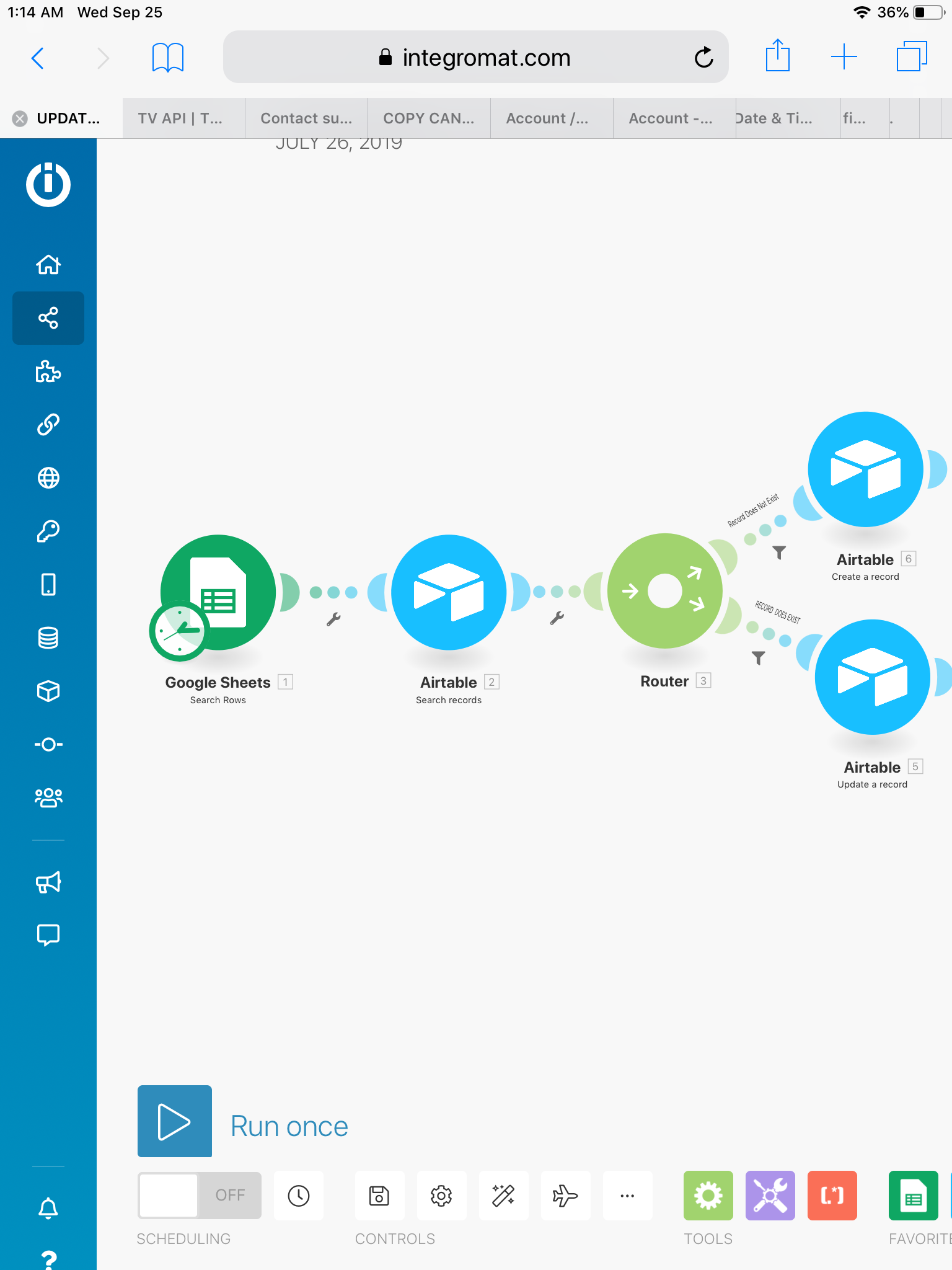

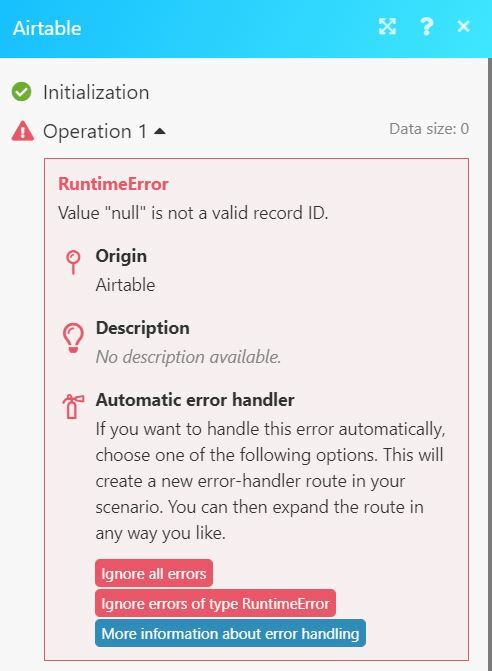

Tried to run just the airtable module only and the problem occurs with the field which is a link to a record in another table.
  • Sep 25, 2019 10:34 AM UTC

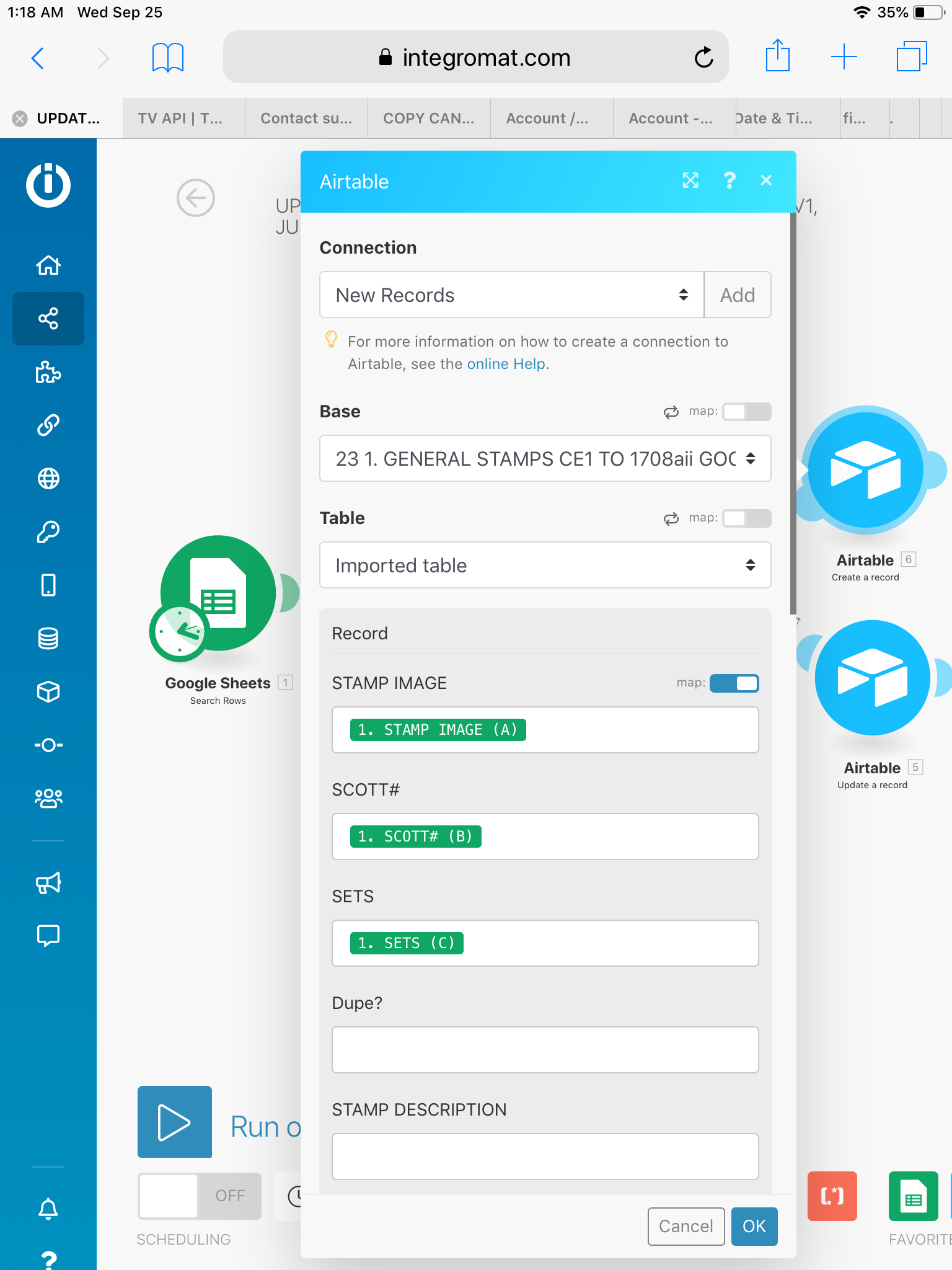

Without being able to see the fields, in the first two modules, it’s a little bit hard to see what field is creating the error.
Hopefully, these two replies will help, together with some screenshots.
Take a look at this post, reply #2:
Also, try this link, post# 21:

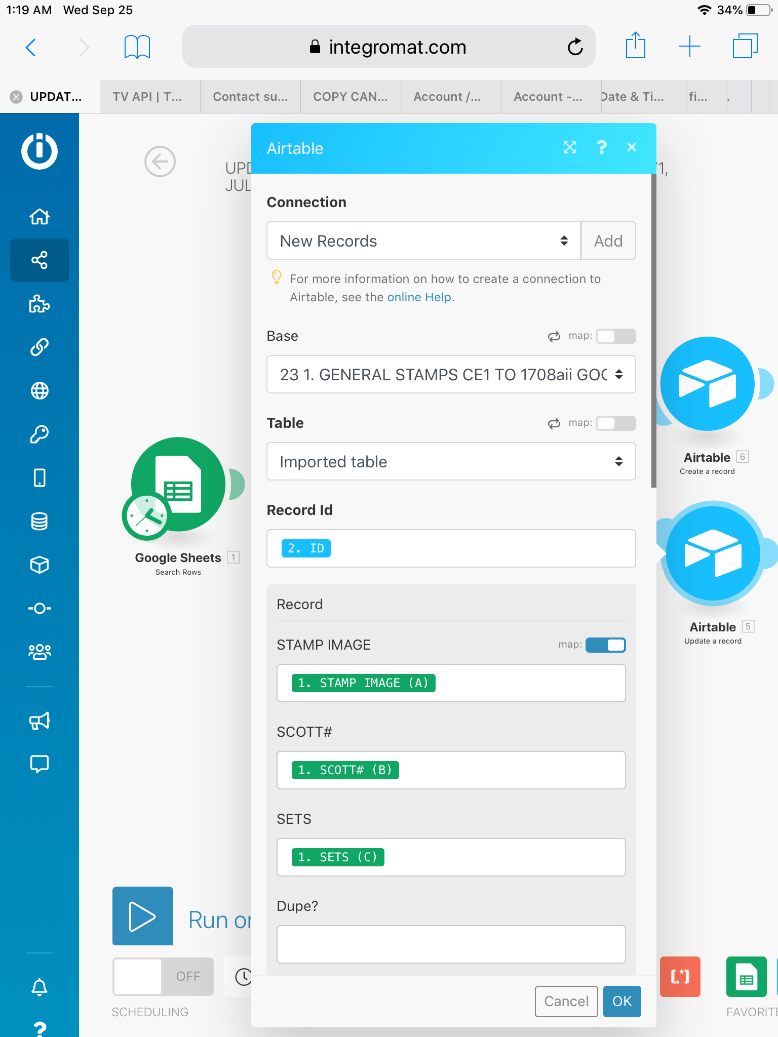

These are screenshots of how your scenario might look like, without the Google Sheet module:
! (upload://f7SBdP1mgJuOtAhHcMMSgzmIe6c.png)
  • Sep 25, 2019 1:32 PM UTC

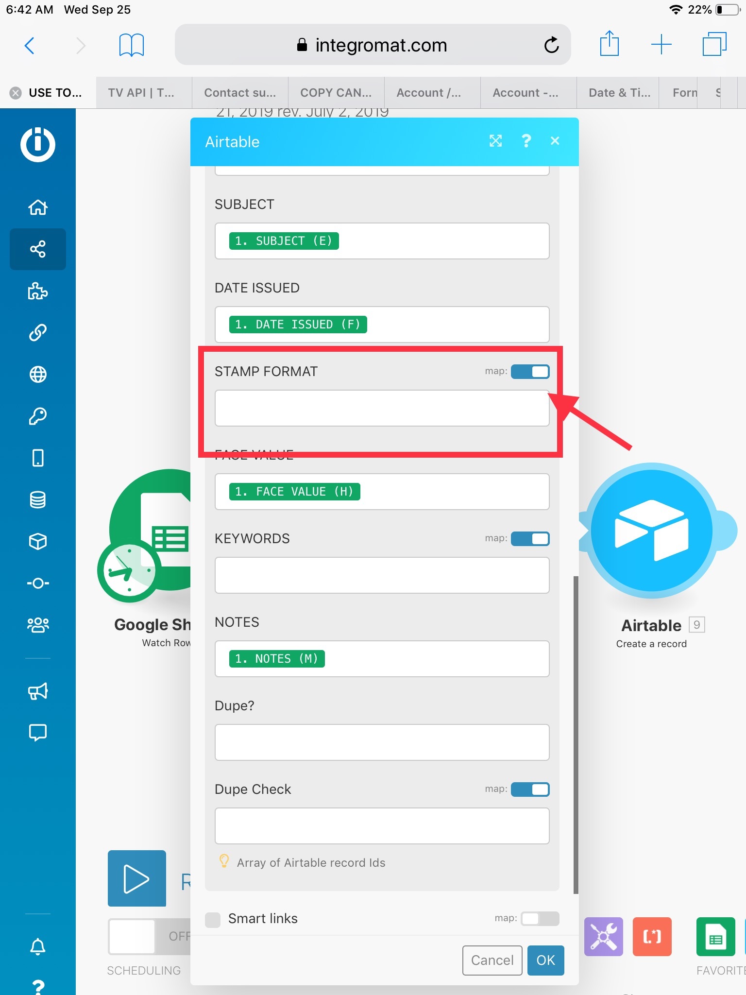

Thanks! I tried it out and it works as long as I leave the linked field empty.
So to localize the question how do I correctly map the linked record field?
  • Sep 25, 2019 1:41 PM UTC
I am glad it works for you.
To fill in that field, try selecting the very small box on top of the field. Once you do that, you should be able to fill in the field.

Thanks. I did switch the “map” toggle and choose the necessary value from the excel file before and got the error “Value is not a valid record ID”. Even though the value matches a record ID in the linked table.
  • Sep 26, 2019 5:16 AM UTC
What does the value look like? It comes from Excel, correct.
How about the formula? Is it written correctly? Although, it might not be that, unless it’s the unique key.
Did you check to make sure that the value is written correctly, in Excel and Airtable?
You should make sure that the field name from both Excel and Airtable match correctly.
If it has to do with a field value it could be the smallest thing, either a misspelling or an extra space, especially at the end.
I am just trying to think of different things to check.
If you could take screenshots of the value in Excel and in Airtable, that might help. Otherwise I am just kind of guessing.
Did you create a new TIME CREATED field in Airtable? Apparently, Airtable requires this field to process the data.
Did you mention that you had linked tables, (two tables together?). If so, are they linked correctly?
I hope these suggestions might help.
I have had situations that I would spend time clecking everything, sometimes a bunch of times.
Mary Kay

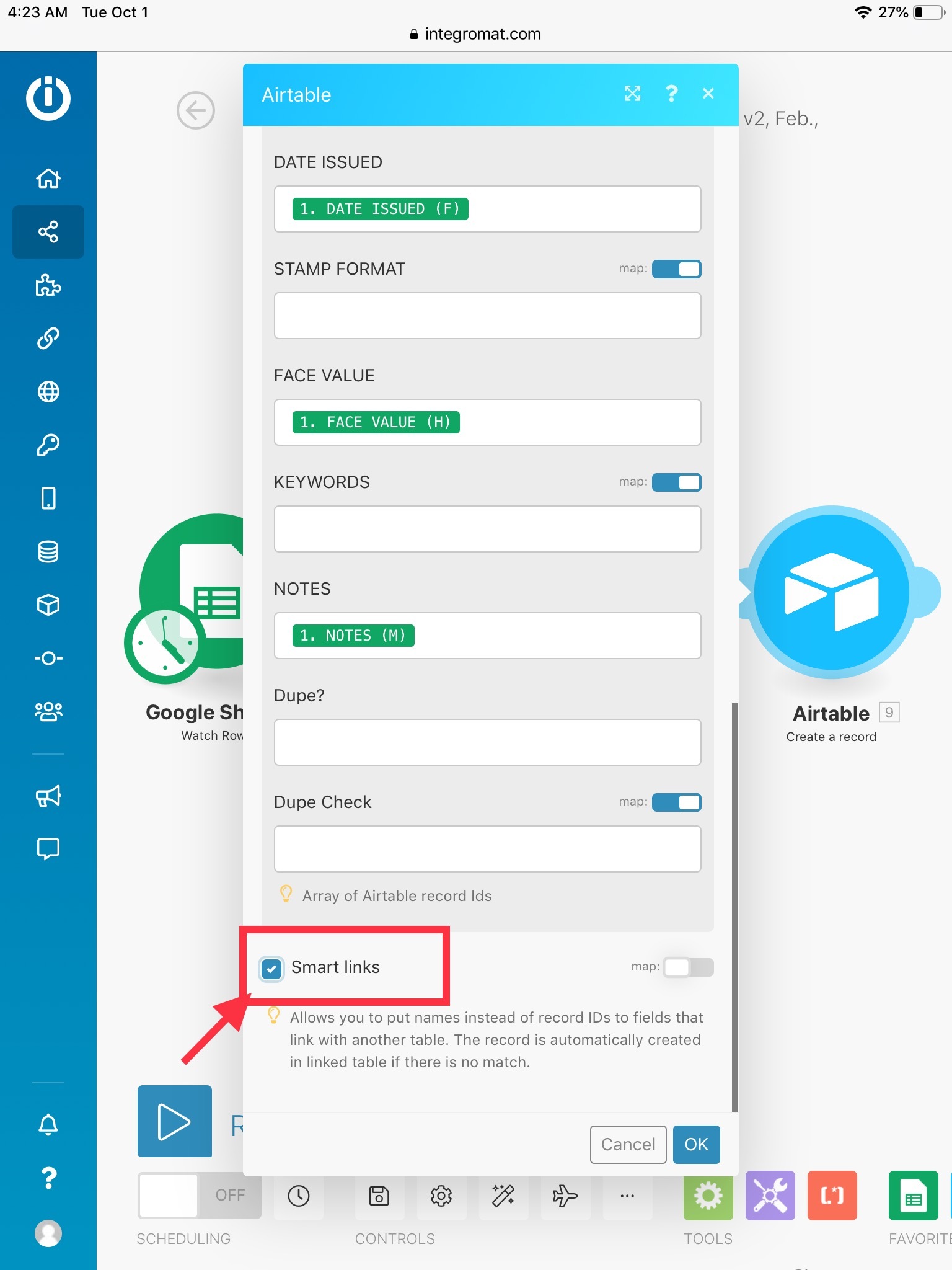

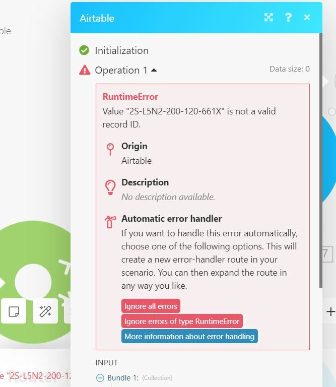

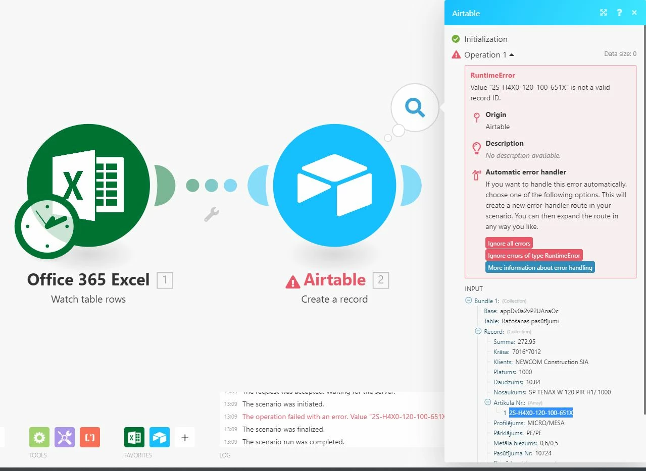

Found out that I can get the records to import if the value for linked field is the unique airtable record ID.
Which is sad because I thought it could work just like when pasting a value in a linked record field it automatically links to a matching record or creates a new record in the linked table.
  • Oct 1, 2019 10:51 AM UTC

by “linked field” I mean A field in an Airtable table of type “link to another record”
It wasn’t support. I found through trial and error that that way I don’t get back the error “Value “x” is not a valid record ID” and the record is added to Airtable.
  • Oct 1, 2019 11:31 AM UTC
Now that I have a bit more of an understanding of what you want to do, I checked the Airtable=>Create Record module and it seems that you might need to select SMART LINKS option, that might work.
Here are screenshots. Chevk it out and see if it will help.

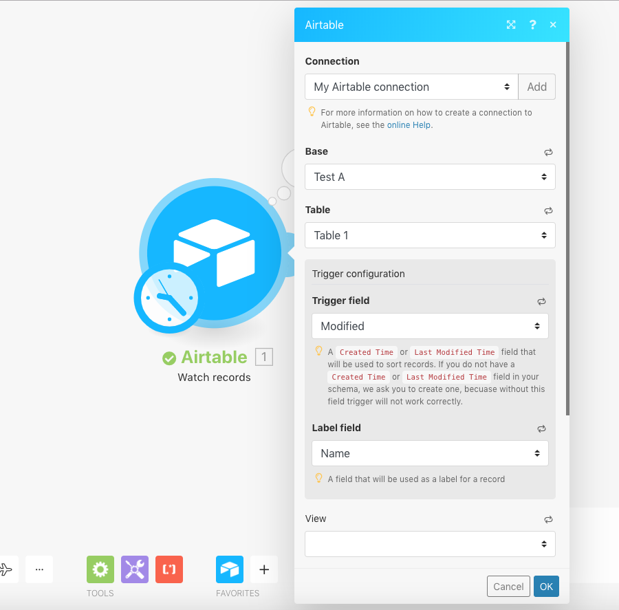

Mary K
Thanks!
That works.
Bit ashamed of how obvious this was. Just learning integromat.
