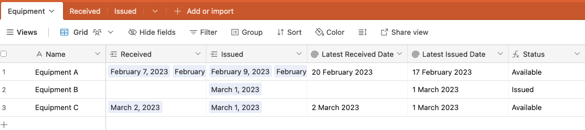

Yeap, this is possible (assuming I have the correct understanding of your base in my head).  Each form submission's linked to the appropriate record in "Equipment" right?
If so, you could use rollup fields with the formula `MAX(values)` to identify the latest "Received" and "Issued" form submissions, and if the "Issued" date is later than the "Received" date, that means it hasn't been returned yet.  You'd then use a formula field to do this check for you, create a view based of the output of that formula field to only show equipment that's available, and then modify your form's linked fields to pull from that view only, ending up with something like this:
Link to base
All in all, probably take someone familiar with Airtable a half hour or less.  If you're not familiar with the rollups for `MAX(values)`, here's a link to a base I've set up that you can refer to.  These two examples together should be enough to get you up and running pretty quickly

Hi Adam,
Thank you for your response.  Sounds like I need to figure out rollup fields a bit more.  I was trying to look at the logic behind the information you linked, but it seems to be view only.  Your inventory processed until disposition was helpful because I think that is what I am looking for.  Looks like you have two separate grids, one containing the data and another with only the "available" items to select from.  Trying to replicate is the challenge at this point.
I think something just dinged and I am hoping you can verify.  In your example, you are pulling date from Received and Issues and if there is no issued date, you are showing rolling up the equipment as available, correct?
Hi Adam,
Ah no, I'm showing "Available" if the "Received Date" is after the "Issued Date"
Yeap, once you duplicate the base you'll be able to view everything.
You can duplicate the base by clicking the title of the base at the top of the screen, then the three horizontal dots on the right, and then the “Duplicate Base” button.
