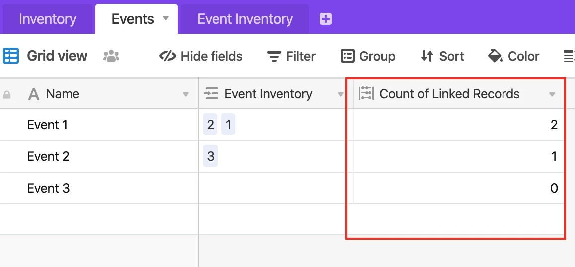

Hi @Kim_Trager1 - this should work OK. Here’s what I did:
In table A create a count field which counts the number of linked records:

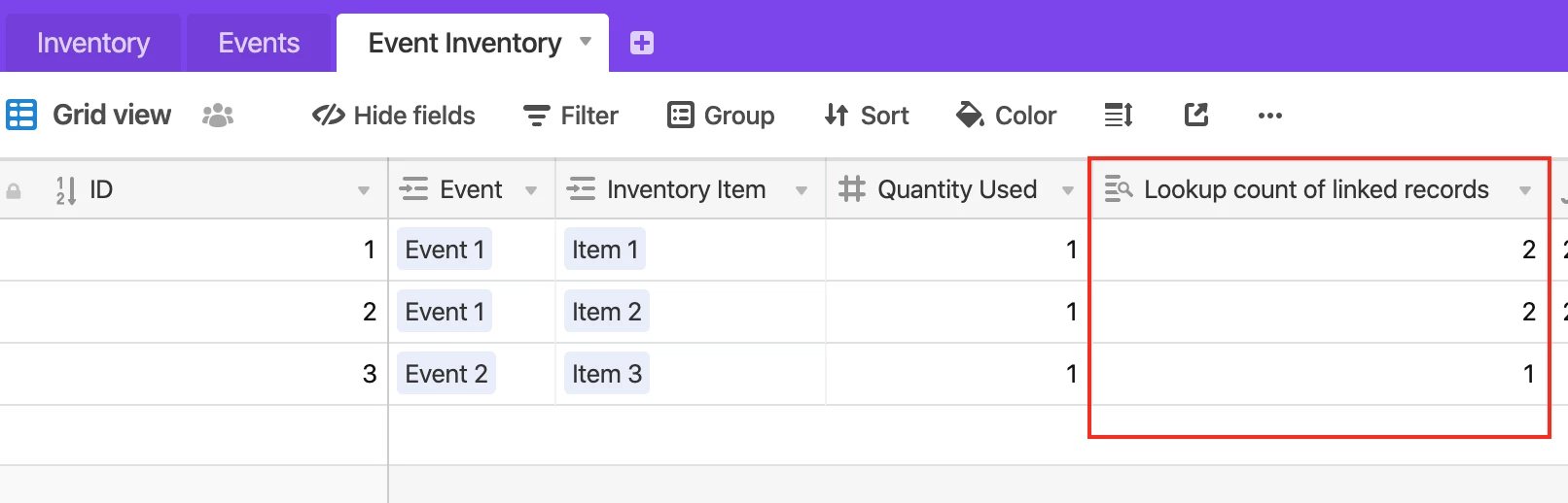

Then lookup this field back in table B (the linked table):

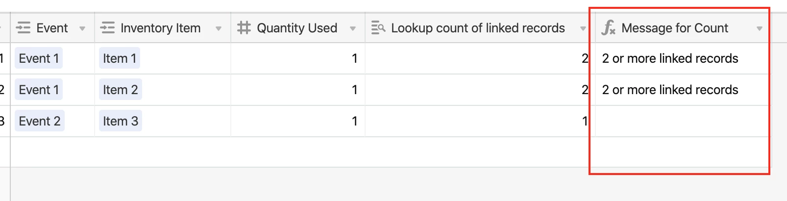

You should then be able to use this field to drive another field in table B. I added a formula field based on the lookup count field:
using:
IF({Lookup count of linked records} > 1, '2 or more linked records')
JB
