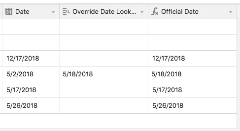

In your Projected Opening Dates table, you’ll need two additional fields (assuming you are already linking a Projected Opening Date to a Project):
  1. A Lookup field to find the “Projected Opening Date Override” from the Projects table
  2. A Formula field that uses the “Override” date if it exists, and otherwise uses the “Date” entered there (I called mine “Official Date”)
IF({Override Date Lookup},{Override Date Lookup},Date)

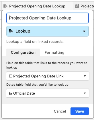

Lastly, you’d want to change the “Projected Opening Date Lookup” in the Projects table to lookup the “Official Date” instead of just the “Date”:
Like I said, it’s not ideal, it’s not pretty, but it’s the only way you’d be able to edit the date from either table.
