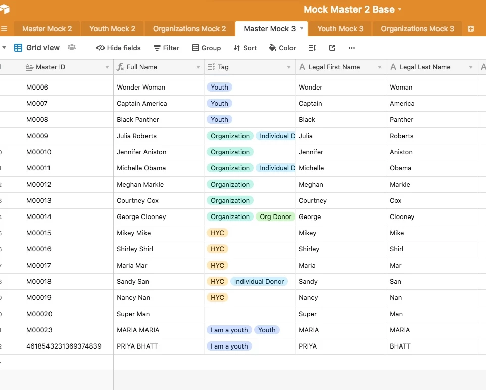

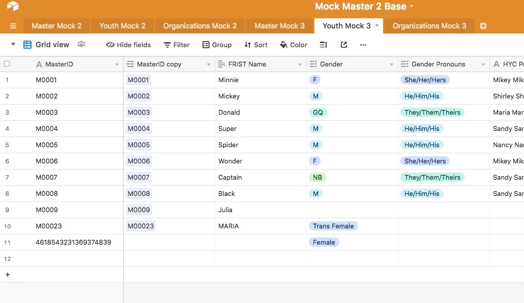

Hi Airtable,
We are rebuilding our database and have some questions. Below you will find a toy example of what we are aiming to achieve.
The first table is our MASTER table (called Master Mock 3). Here we have a number of fields, where the primary key is a unique ID (called ‘Master ID’). Any ID with an MXXXX, where X = a number, is a manually entered record. Any 18-digit numeric string is a submission directly imported from JotForms using the Airtable API.
The second table is our YOUTH table (called Youth Mock 3). The YOUTH table is a subset of records that are tagged as ‘Youth’ in the MASTER table under the “Tag” (but these records were uploaded manually, except for the last which was brought in by JotForms). The YOUTH and MASTER Tables are linked based on the “Master ID” Fields (MASTER:: MasterID, YOUTH:: Master ID copy).
HOWEVER, when a new record is imported through JotForms, the Master ID fields in the YOUTH and the MASTER tables are not linked. How do we go about doing this? We also noticed that Master ID must be a Single Line Text type or a Long text type for JotForms to import the ID.
Ideally we would NOT want a ‘Master ID copy’ field and instead we would like to link the Primary Key’s of the YOUTH table and the MASTER table. Can you please guide us?

Hi Airtable,
