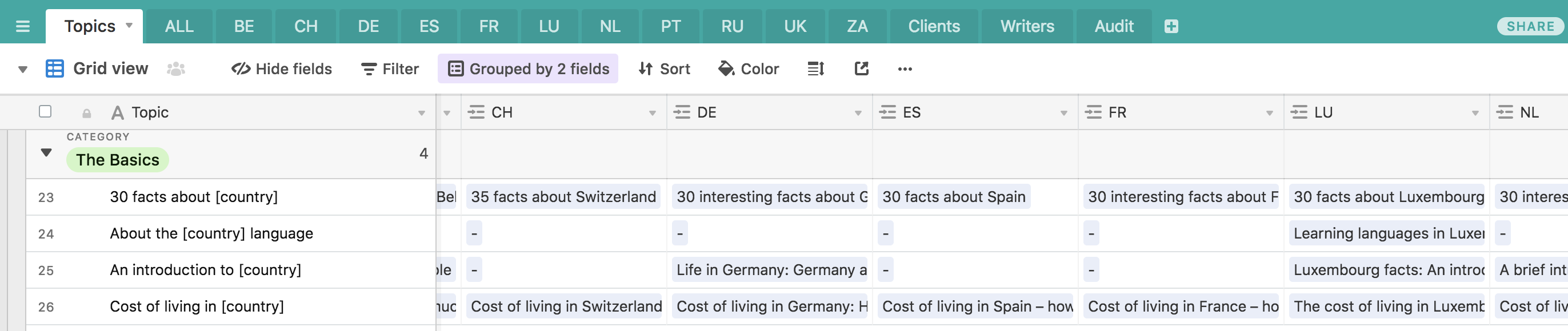

You might consider changing your setup slightly to make the best use of the database structure in Airtable.
I’ve set up an example for you here:
The strength of this approach is that whatever details or assets you’ve set up for one topic will be available across all countries.
The weakness of this approach is that it doesn’t tell you what gaps there are for articles in the view that you’re used to using (it’d be under Categories instead).

I like my current set-up, which I can’t share because it’s too full of proprietary and confidential client information, but there are many things about it that are similar to yours. I use linked and lookup fields all over the place, which are really nifty (did not know about the lookups just yesterday!) and I am sure I will find many great tips in what you gave me here.
What I like about having a table per country is that the topics table gives me this immediate view of what’s available:
and thanks to lookup fields, all I’ll have to do when I create a new topic is type a dash in every column - which is not HORRIBLE. Also, Airtable support told me that they’re going to implement that automatic field creation thing some time in the near future… yay…
Thank you again; I will let you know when I’ve gone over your post in detail - it’s too late now, I need Zzzz.
