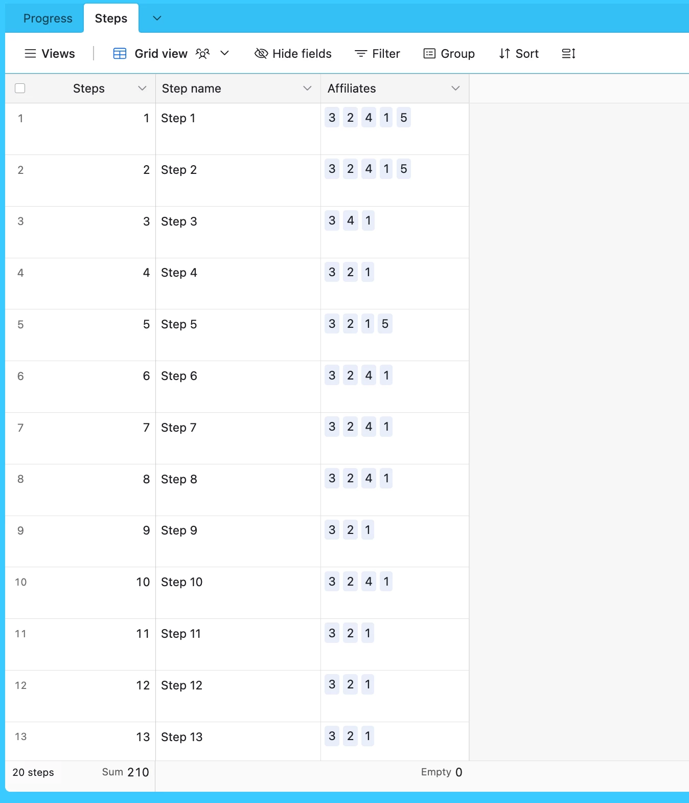

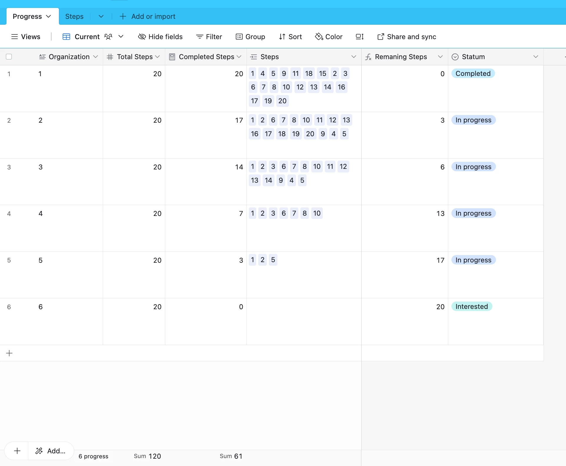

I have created an airtable base to see what steps different organizations need to take. I have a list of all of the steps in one table. And a list of all organizations in another. I have a linked column connecting the two to show what steps each organization has taken. I am trying to make it so I can easily see the steps that an individual organization has NOT taken yet/ what they still need to do (They all have to do all of the steps). I don't necessarily care how it is done as long as I don't have to do it manually and can easily see what steps have not been taken by each organization.
For example, I want Organization 2 to say that it still needs to do steps 15, 19, and 20 (the steps do not have to be done in order for the most part).
Images and an example base are attached for a better understanding of what I am trying to get at. Link: https://airtable.com/appP3aMz3aJ2jYLGp/shrnb4rpltjlBPdZH/tblbT6mtF29tzfsbF/viwiytG0caCqn0XZT?blocks=hide
Thank you for any help that you can provide!!

You'll need two linked record fields. One for tasks assigned, and one for tasks completed. An automation or script can highlight the tasks that are incomplete of those assigned.
You can use an automation to auto assign tasks from a view. Then, as tasks are completed, add them to the Completed tasks linked record field. An automation would handle the unfinished tasks out of tasks assigned.
Alternatively, Have a third mapping table of tasks assigned per org. each task assigned to each org will be one record here. You can then rollup finished and unfinished tasks easily. From a db perspective, this is a more solid approach.

Yeap, formula wise it'd be the same, it'd just be a pretty long formula
Having the Org <> Steps table would be nice yeah, and it would let you track specific data tied to each task too
