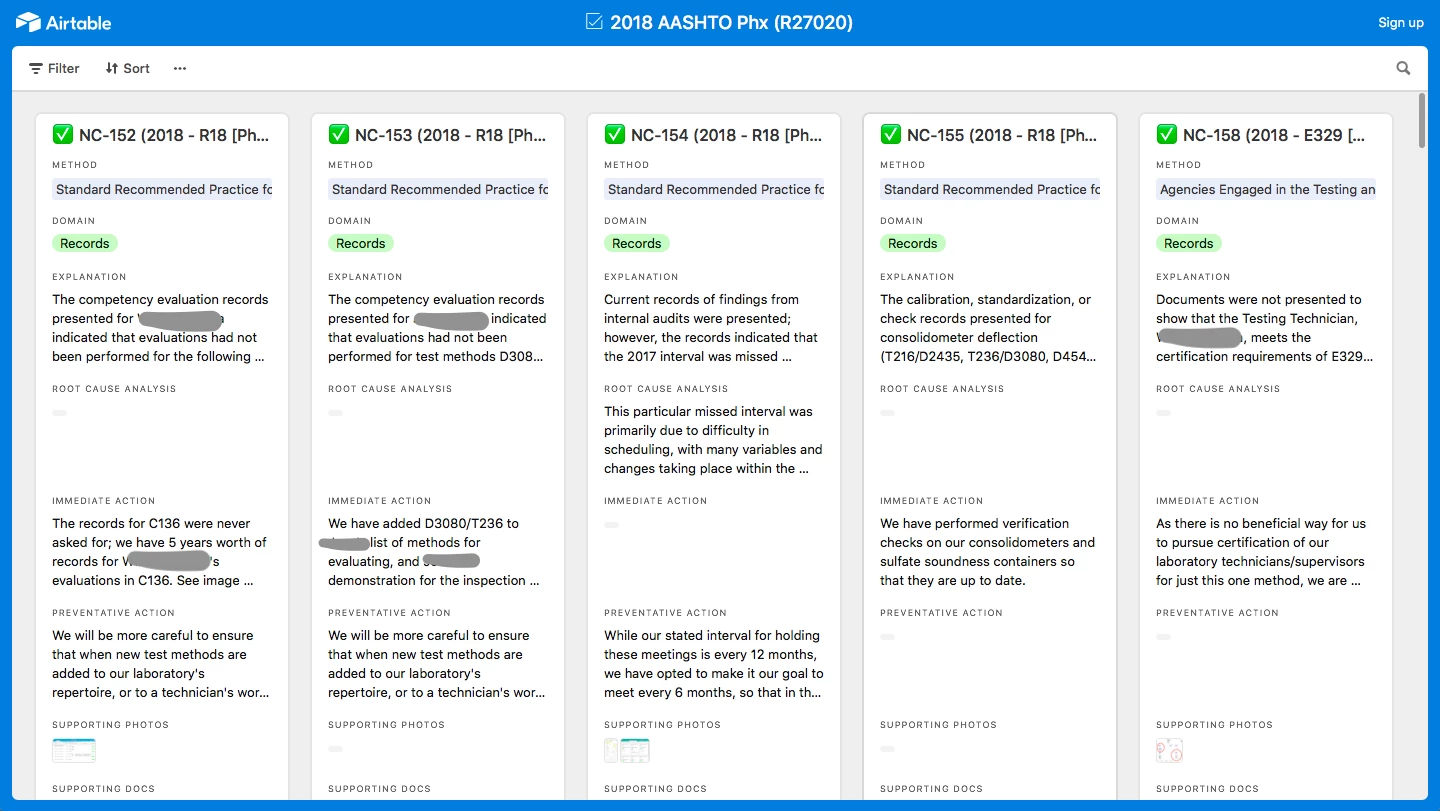

So if you have all these views named for the employee, you can then (if you need to) share an employees view with them, and as the title they will simply see their own name (the name of the view, not the name of the entire base). Here’s an example of a shared gallery view – the title of the entire base is “Assessment & Accreditation”, but all the external viewers of my shared view see is the title of the view I’m sharing:
