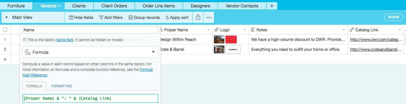

  7. You can now go back into Table1 and change the “first column” to reference any field (or combination of fields) you would like. I find that using a Formula Field for the “first column” allows me to change the exact text of the relationship field frequently depending on my needs. For example, since Airtable auto-completes when you’re doing text entry based on the linked field, sometimes it’s more convenient for a set of tasks to use the email address, while other times I want the full name… and then I can always do both with the Formula, "{Name} & “: " & {Email}” … it’s a very flexible way to manage linked tables through a variety of fields rather than just one.

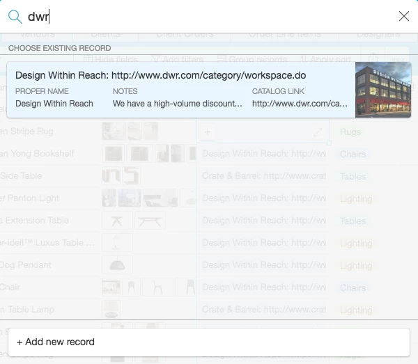

Here’s a brief example using one of the default templates. I created a new “second column” named “Proper Name” and copy/pasted column one into column two. I then changed column one into a formula that concatenates the Proper Name and the Link into one field.
Then when I’m in a related table, I can use the auto complete to lookup the related record by a fragment of the URL, not just the name.
