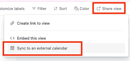

Then you’d create a Calendar view and sync that to an external calendar:
