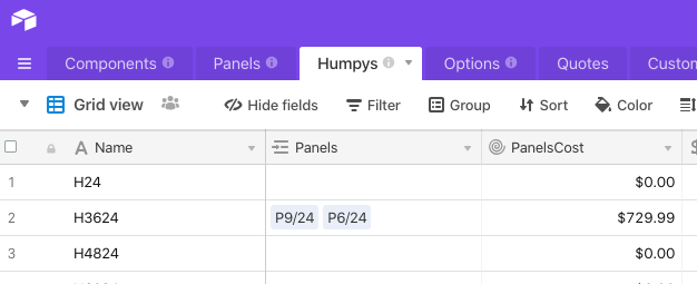

See screenshot attached. Components have a cost, multiple Components make up a Panel, multiple panels make up a Humpy. BUT - a Humpy may have, for example, 6 x P6/24’s and/or 3 x P9/24.
How can I multiple each of the panels by a number in order to calculate the PanelsCost?
Thankyou.

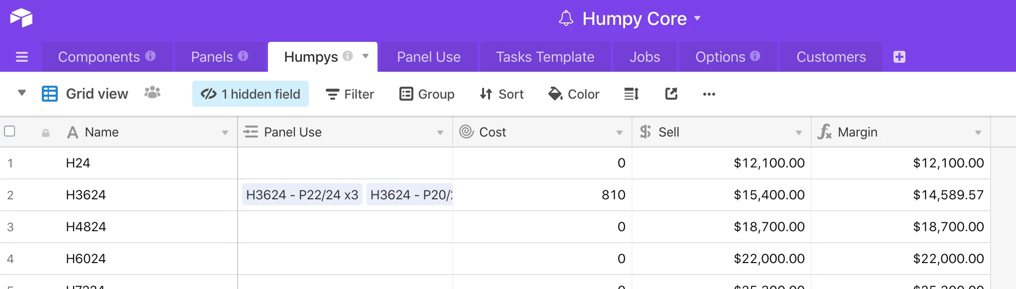

Here’s a shot of my other tabs in question in case it helps.
Sorry, are you able to elaborate on this line? I’m not sure what that does or what the result should look like.
That line does just what the description above it indicates. It takes the values from the {Humpy}, {Panel}, and {Quantity} fields and uses them to build a string, which acts as a convenient descriptor for that record. The & operator concatenates the pieces around it and outputs a string.
The {Name} field in the screenshot from the [Panel Use] table shows what that formula outputs. Here it is again:
It provides a quick view of the Humpy the panel is assigned to, the panel name, and how many of that panel are assigned in that record.

Just dropped in to say Thanks @Justin_Barrett. It’s working a treat.
