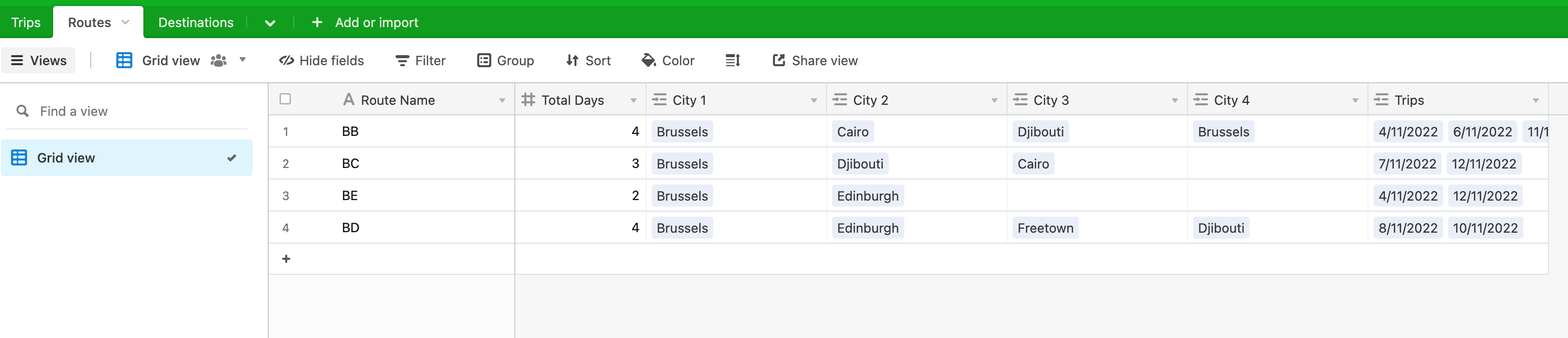

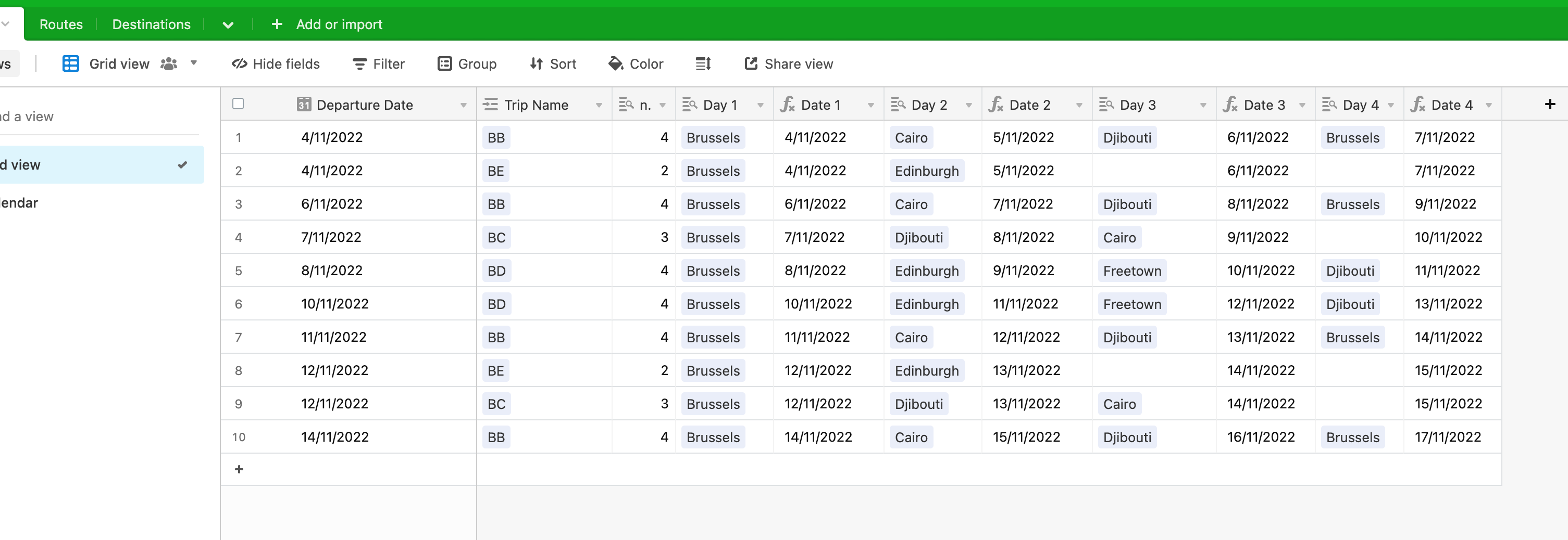

I am relatively new to Airtable and have a specific Search/Filter issue that my colleagues and I have been attempting to solve for a while now. We are a small travel company that provides tours to our clients. Each tour has a unique route that it travels (with stops along that route).
The tour itself can run on multiple days following the same route.
I have set up our tables in a similar fashion to this screenshot:
We need to be able to create a Search that will return which Trip Name is in a City on a specific date or range of dates.
For example: we search Djibouti from 10/11/22 - 13/11/22, it would return BC, BB, BD, after which we could view individual records that BC, BB or BD are within.
Is this within the realms of possibility with Airtable?

I was trying to do something very clever by passing back-references from Trips through Routes and into Destinations and then create a column called “Dates in Destination” with a list of every date where there is a trip in the destination, but:
  • It wouldn’t have given you the linked Route/Trip object for each date easily
  • The resulting dates would have been (hard to read) text representations that wouldn’t have worked with the Date filters
