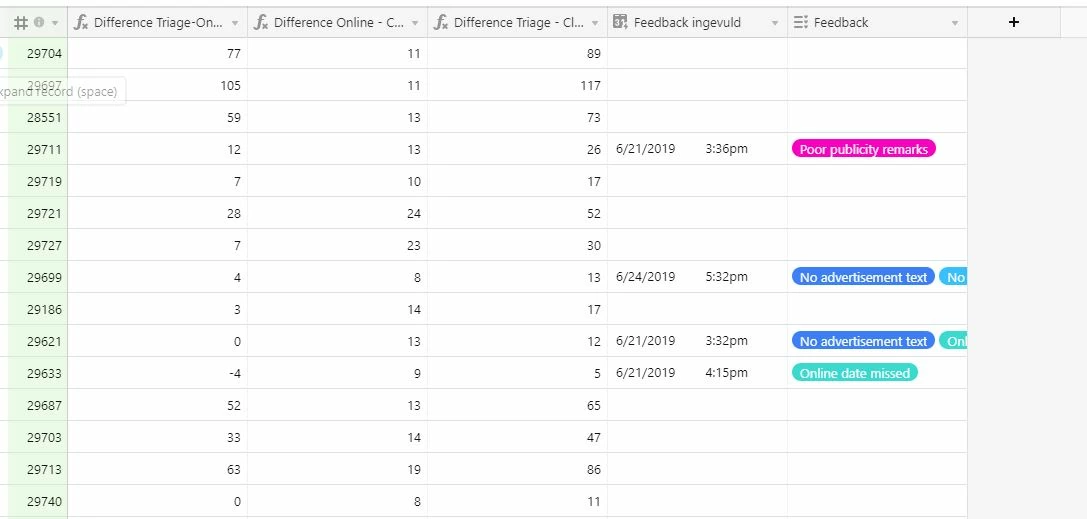

I have a simple although also quite complicated formula which is not working for me.
I want to create 1 view with projects which have specific fields filled OR which have a value with specific criteria.
I want to filter on all fields with Feedback filled OR with a value <14 in the second, third or fourth column.
I came up with:
AND(
{Difference Triage-Online date} =<1 7,
{Difference Triage - Closing} =< 14,
{Feedback} =! BLANK(),
{Feedback ingevuld} = yesterday
“TRUE”
Can anyone point me in some direction? Thanks!

Try:
IF(OR({Feedback}, AND({Difference Triage-Online date} =<14, {Difference Triage - Closing} =< 14, DATEADD(TODAY(),-1,'day')=DATETIME_FORMAT({Feedback ingevuld},'M/D/YYYY'))),'True')
Hi Kamille,
Thanks for the help, however it gives an error.
I think its better to skip the part of ‘feedback ingevuld’ since that part is optional. However, this wont work as well:
OR(
AND(
“True”

You’re missing a parentheses to close out your OR() statement, and have an extra comma after the second “14”. :slightly_smiling_face:
I would also modify the formula to drop the “=! BLANK()”. It’s a good idea to avoid BLANK() as much as possible as Airtable has trouble with that function sometimes for some reason.
IF({Feedback} … is the same as IF({Feedback} != BLANK()
Try this:
IF(OR({Feedback}, AND({Difference Triage-Online date} =< 14, {Difference Triage - Closing} =< 14)), "True")
