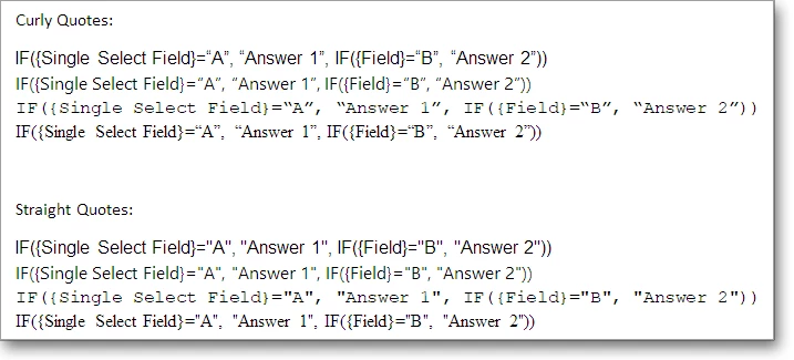

There can’t be a space between ‘IF’ and ‘(’.
(I’m assuming the curly quotes in your example are an artifact of your posting them in this forum. If they are part of your formula — for instance, if you copy-and-pasted that section of the formula from a post on this forum — replace them with straight quotes as entered from your keyboard.)
Also, it’s often easier when dealing with long or complicated IF() statements to compose them in another editor — I use Notepad++ because of its automatic parenthesis-matching capabilities; there are similar apps available for macOS and Linux — and then paste them into Airtable. Note that you can paste indented code into an Airtable formula and have it work; even better, the indentation is retained should you later wish to copy-and-paste it from Airtable into your editor.
