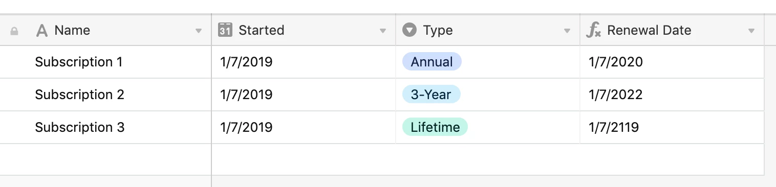

HI @Colleen_Malloy - you might find a SWITCH() formula to be easier to handle and works well in these situations (where you want a result based on one variable having a number of values). Try this:
SWITCH(
  Type,
  'Annual', DATEADD(Started, 1, 'years'),
  '3-Year', DATEADD(Started, 3, 'years'),
  'Lifetime', DATEADD(Started, 100, 'years')
(Note that “100 Years” has been used as a proxy for “lifetime”).
JB
