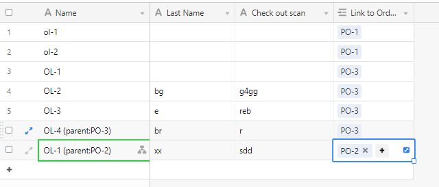

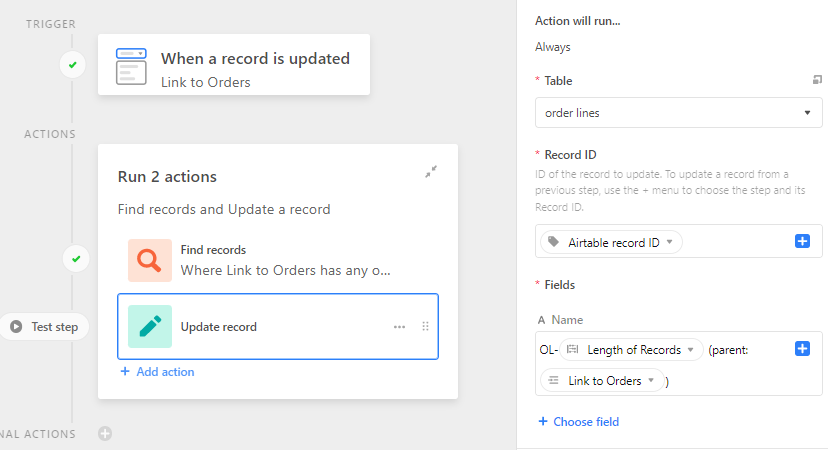

I’m too sleepy for longread, but i think, logic is clear (for automation) - when OL links to PO, use count of PO links to number OL. You can’t use value of PL which is not trigger, but you can evaluate it from ‘other side’ - by Find records - length
just for example (during test i decided to install ‘parent’ value)
  • Sep 14, 2022 11:10 PM UTC
