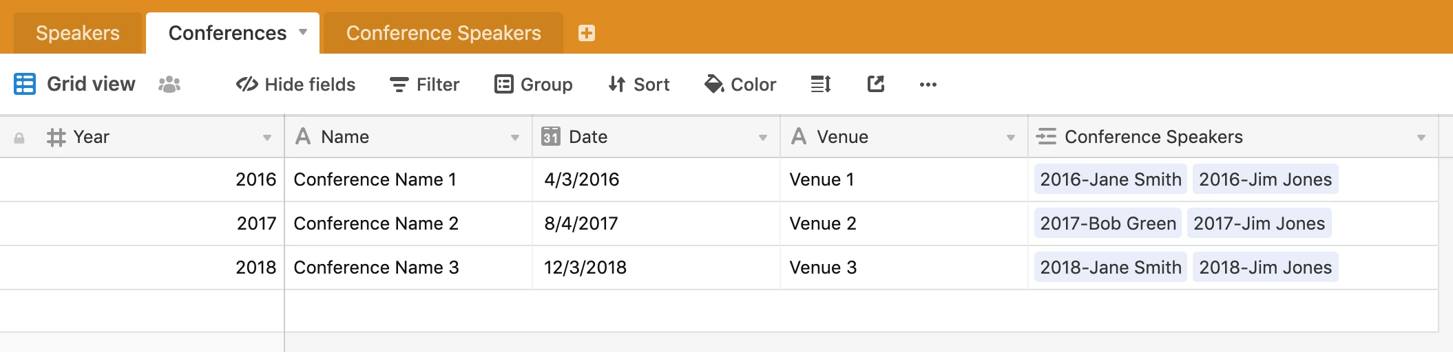

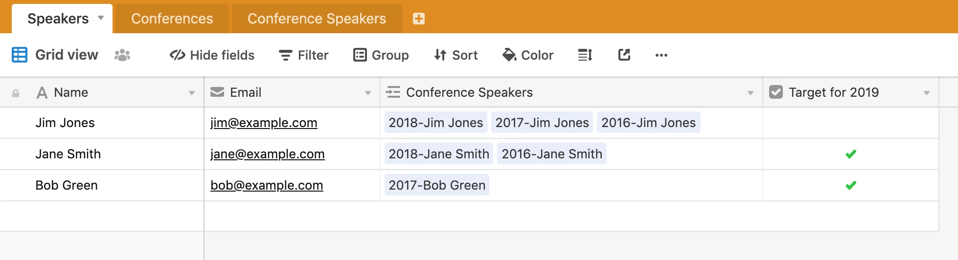

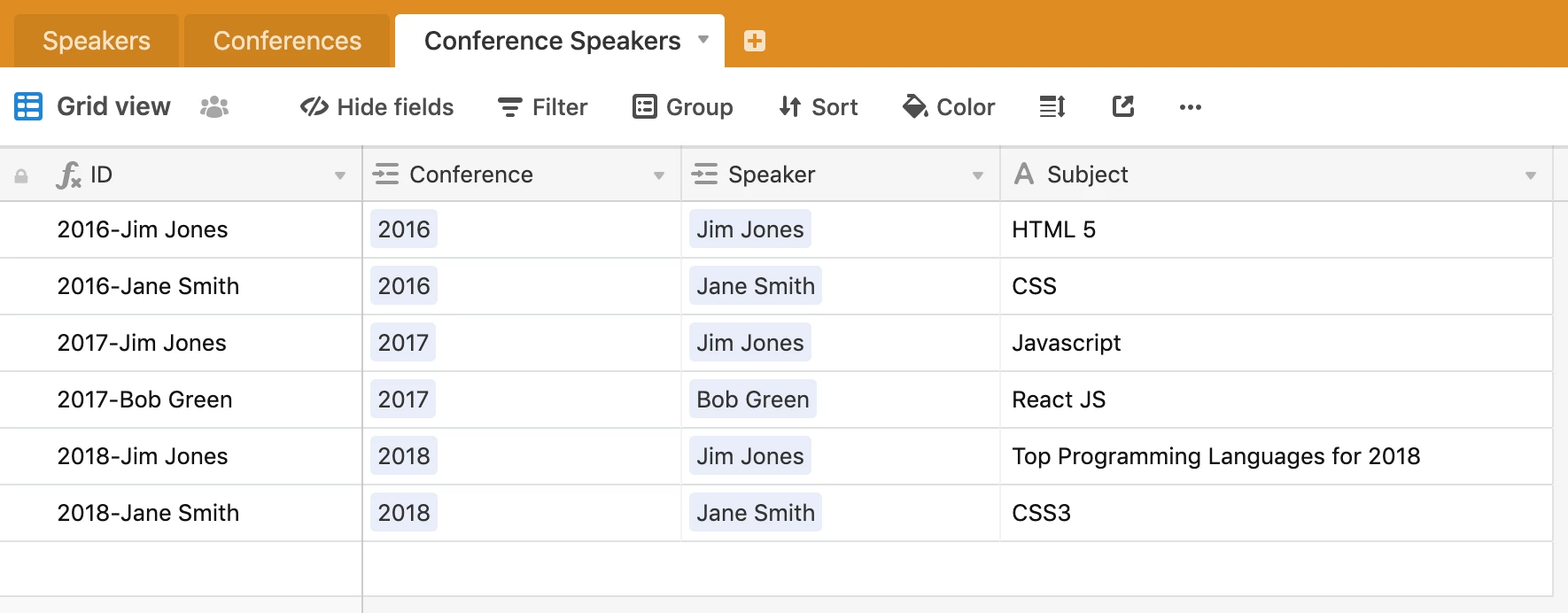

Hi @Brett_Cannon - Lots of ways to do this but I would approach this base in this way:
3 tables - one for speakers, one for conferences and one that joins speakers to conferences:
This structure allows you to capture speaker, conference and speech information independently, but by linking the tables information in one table can be linked to or looked up in another. It also allows for variances in some attributes over time, e.g. a speaker may not always deliver the same subject matter every year. Sorting and grouping can be used to get the appropriate views of the data for your process.
Your “Master List” table is a bit like my Conference Speakers table, but I’m not sure what you mean by:
In my example, the table links allow you to populate the speaker field with an existing speaker rather than auto-populating.
Hope this helps
