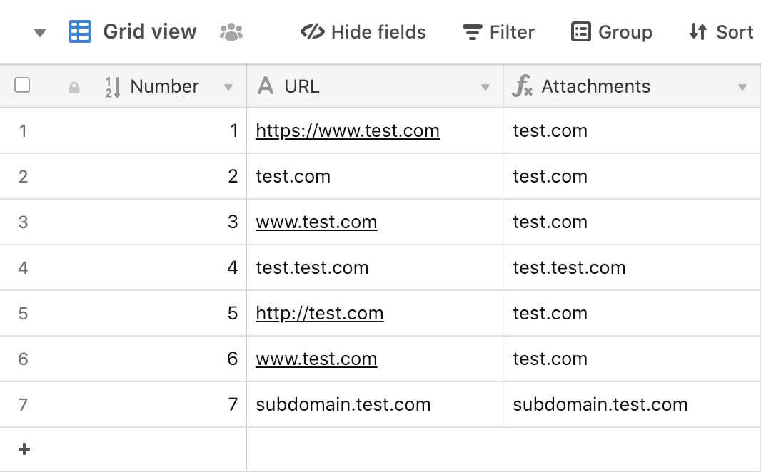

here’s what it looks for me when testing:
I’m sure there are more efficient ways to do this and there might be some things left over that you don’t want but maybe a good starter still.
