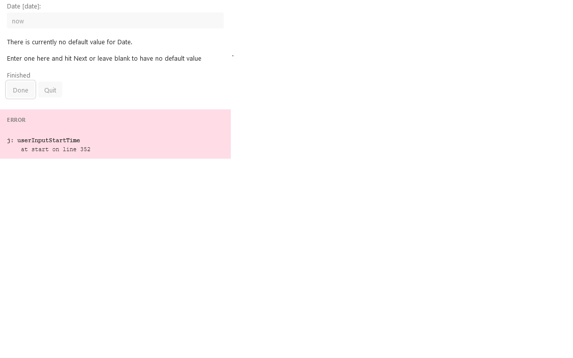

  • Sep 6, 2021 5:46 PM UTC
Image of error
App: Scripting
To activate: Run → Configure Defaults → “table name” → Grid view → Date
I set Date to now
I click “Next”
I make no other changes
I click Done
Error message:
j: userInputStartTime
at start on line 352
Scripting code looks for 'now" for today’s date (line 141 and 142):
}else if(type === ‘date’ || type === ‘dateTime’){
value = value.trim().toLowerCase() === ‘now’ ? new Date().toISOString() : value
