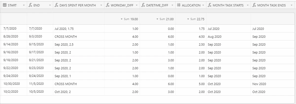

However, it’s not exactly the solution I’m looking for. :grinning_face_with_sweat: I’m sorry, I think I may not have explained myself properly. Below is a screenshot of the table I’m testing this out on:
I have the two columns indicating the “START” and “END” dates for a task. If the start & end occur within the same month, calculating working days it takes to finish the task is pretty straightforward.
However, as soon as the end date crosses over into a different month, I’m not sure how to separate the tally of the working days by month.
The end result I’m looking for would be something like: Oct 2020, 1.0; Nov 2020, 3.0
Just FYI, the formula I have in the “DAYS SPENT PER MONTH” column is:
    IF(IS_SAME(
    {MONTH TASK STARTS},
    {MONTH TASK ENDS},
    'month'),
    ({MONTH TASK STARTS}
    &", "&{ALLOCATION}),
    IF(IS_AFTER({MONTH TASK ENDS},
    {MONTH TASK STARTS})=1,
    "CROSS MONTH"))
