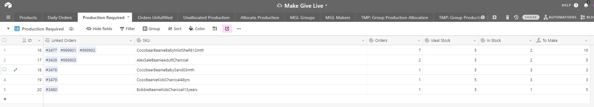

Hi
I simply need to add some records to a table into a "Linked Record’ field. I struggle to understand why it’s so difficult.

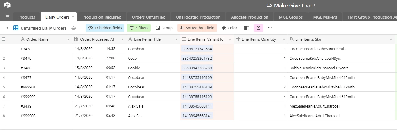

I have this VIEW:
and I want to add single and concatenated ‘Linked Orders’ via a script.

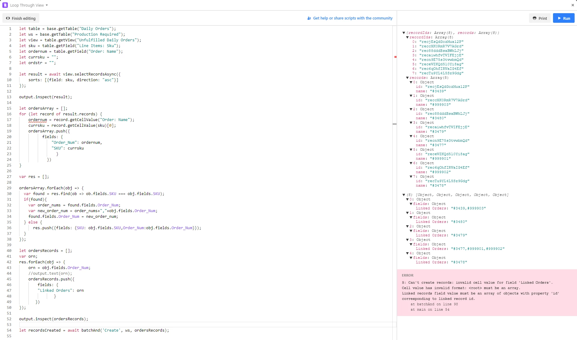

This my array of records I’d like to add…
Here is my code and results…
full code

I’m assuming it’s something I must do with the recordids but just not sure what :-).
Can someone help and share some example code with my field and table names please.
Thanks so much
Claire

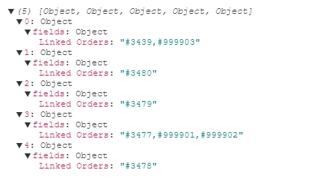

Yeah, it’s kinda tricky. In short, linked record fields need to be passed an array of objects. Each object must have an id property assigned to the ID of the record you wish to link to. For example, if you want to make two links, it would look something like this:
[{id: "recXXXXXXXXXXXXXX"}, {id: "recYYYYYYYYYYYYYY"}]
That array is what needs to be passed to your {Linked Orders} field toward the end of the script.
Long story short, it looks like you’ve got most of the code properly structured. What you need to do is replace the references to the order number (in various places) with a record ID object following the structure I outlined above.

This modified script should do the trick. Here are the changes I made:
  • The main optimization was replacing order number references with record IDs. What you see when linking to a record in another table is the contents of its primary field, which in this case is the order number. However, Airtable is internally tracking the record IDs of linked records, which is why it asks for an array of objects containing those IDs.
  • I also removed some unnecessary nesting of the helper objects. The only place where you absolutely need an object containing a “fields” property which is, itself, another object is when passing data to Airtable. Using that nested structure for the earlier steps just made them unnecessarily complex.
I didn’t build a test base to test this new code, but I gave it a pretty thorough review, so it should work. If you hit any snags, let me know.
let table = base.getTable("Daily Orders");
let ws = base.getTable("Production Required");
let view = table.getView("Unfulfilled Daily Orders");
let sku = table.getField("Line Items: Sku");
let ordernum = table.getField("Order: Name");
let currsku = "";
let ordstr = "";
let result = await view.selectRecordsAsync({
    sorts: [{field: sku, direction: "asc"}]
output.inspect(result);
let ordersArray = [];
for (let record of result.records) {
    currsku = record.getCellValue(sku)[0];
    ordersArray.push({
        Record_ID: record.id,
        SKU: currsku
var res = [];
ordersArray.forEach(obj => {
    var found = res.find(ob => ob.SKU === obj.SKU);
    if(found){
        found.Record_IDs.push({id: obj.Record_ID});
    } else {
        res.push({SKU: obj.SKU, Record_IDs:[{id: obj.Record_ID}]});
let ordersRecords = [];
res.forEach(obj => {
    //output.text(orn);
    ordersRecords.push({
        fields: {
            "Linked Orders": obj.Record_IDs
output.inspect(ordersRecords);
let recordsCreated = await batchAnd('Create', ws, ordersRecords);

Thanks Justin, much appreciated. Works perfectly. I condensed the linkedorders array down further with this…
const skus = [...new Set(ordersArray.map(obj => obj.fields.SKU))];
const linkedRecordsArray = skus.map(sku => {
    return {
        fields: {
            'Linked Orders': ordersArray.filter(obj => obj.fields.SKU === sku).map(obj => ({ id: obj.fields.id }))
