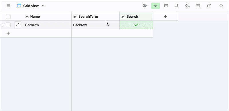

Its super clunky, but you could include a formula field called “SearchTerm” where you set the formula value to the term you want to search:
"Backrow"
and another formula field called “Search” with the following formula:
IF(FIND({SearchTerm}, {SearchField}), TRUE(), FALSE())
Set the formula format to Checkbox, then filter using that field.
Then all you have to do is change the contents of the SearchTerm field to whatever case-sensitive text you want to search for.
Super clunky, but gets the job done for quick searches.
"Backrow"
