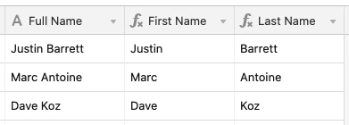

The above is great, but I don’t care about suffixes. Just how to split the first and last name. How do I do that?
First name:
IF({Full Name}, REGEX_EXTRACT({Full Name}, "[^ ]*"))
Last name:
IF({Full Name}, REGEX_EXTRACT({Full Name}, "[^ ]*$"))
Both of these use the [^ ]* combination, which captures any number of non-space characters. By default the source string is parsed from left to right, so the first expression will stop once it hits the space between the first and last name. The $ at the end of the second expression tells the parser to begin at the end of the string, effectively working backwards until it hits the same separating space. Because the space is ignored in both cases, there’s no need to trim anything.
First name:
Last name:
This response is really helpful! The challenge I’m running into is that many of the people on my spreadsheet have multiple last names. Which means that when I use this formula it only pulls out the very first and very last names listed. For example:
Is there a different way to write this formula that will include all of the last names?
The easiest way to do that is to remove the first name and its trailing space from the original string. Change the formula for the {Last} field to this:
IF(AND({Full Name}, First), SUBSTITUTE({Full Name}, First & " ", ""))
Worked like a charm! Thank you

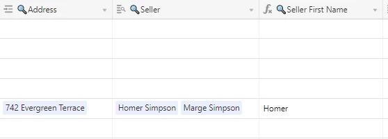

A lookup field returns an array, not a string, and doesn’t auto-convert to a string when a formula asks for it. To convert an array to a string, concatenate it with an empty string. In your formula, anywhere that you have:
{Client Name}
you will need to change it to:
{Client Name} & ""
In regards to the formula for using it lookup fields, what if you have multiple items in the look up field as such. How would you bring in second or third name if possible?
  • September 18, 2022
Split the names in the original table. Then lookup the individual names.
Nicole_Merwin
Dang it, that was not the answer I was hoping for :slightly_smiling_face: I was trying to save fields in the original table. Thanks kuovonne!
