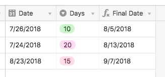

I was doing this:
Formula:
DATEADD(Date, Days, 'day')

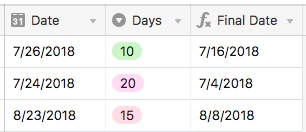

Negative
Formula:
DATEADD(Date, -Days, 'day')
